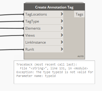

Are there any packages which supports multi category tags. I have used create annotation tag node from archilab package and works fine for tags types other than multicategory tags. As soon as i feed a multicategory tag it give me this error image

You can use the node from Genius Loci package : Create Annotation Tag (MultiCategory).
It’s a small variation on the node from Archilab. (Thanks to Konrad)
Multi%20category
Thanks @Alban_de_Chasteigner will try that
That did the trick Thanks Alban
