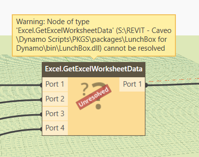

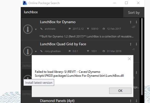

I have installed/uninstalled/installed (repeat 700 times) the Lunchbox package. Although it says it’s installed, my script won’t read it & it doesn’t show up under my toolbar. Suggestions?

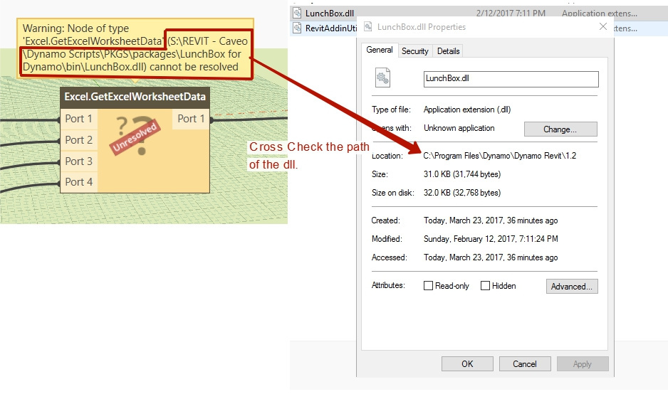

@cwilliams Could you please cross check your dll file location. Your first image error shows your importing dll from S drive. Go to the path of S drive and right click dll file-> properties.

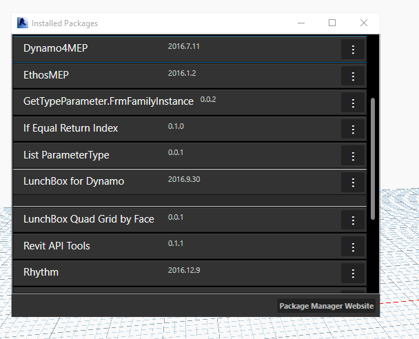

@cwilliams Could you show your packages paths location?
I was able to download a version from 1.2015 which now shows up in my toolbar. However, it’s still giving me the error in the script, even though it’s referencing the location. Also, when I click on the “bin” folder, the .dll isn’t in there, but then how can it be loaded?
Under “installed packages” I clicked on LunchBox for Dynamo & clicked “show root directory” which is what is in the clip above.
I continually get this error when installing from my server.
