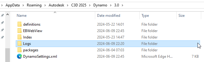

For Civil 3D the log file can be found at
%Appdata%\Autodesk\C3D “Civil 3D version”\Dynamo\ “Dynamo version” \ Logs
