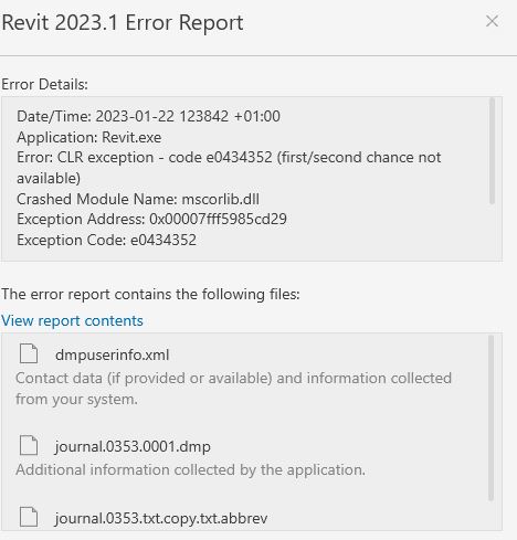

Revit freezes when trying to open Dynamo. I have to manually finish the process from windows task manager. No Revit crash report is generated. Revit 2023 with latest update version installed 2023.1.1.

Thank you for answering Andreas. I have done it just before sending the log file. Is there a way to get a clean installation of Dynamo, in order to recover those folders?
Finally, just the vesion Revit 2023.0.2 reached to replace the empty folders with the new ones. None of the other Revit Hotfix did the job.
I could install the newest Revit 2023.1.1 after installing that vers, and get Dynamo working.
