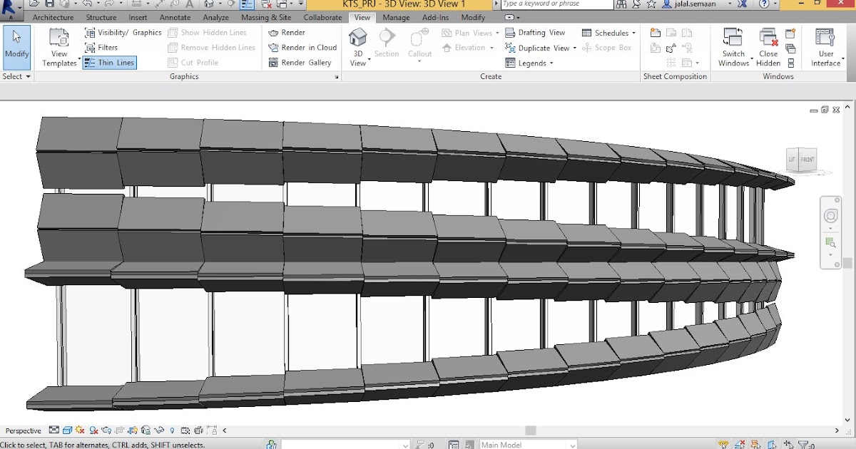

So I wanted to practice my Dynamo/Revit skills and thought that making a kinetic panel would be cool (it is). But after many errors and some much appreciated help from the forum I managed to make it work. Or so I thought. Literally half of my panels work. Here is what I mean:
I am utterly baffled. Would appreciate it if someone could figure out what kind of dark magic this is and explain it to me.

This is great for any version of revit below 2017. But from 2017 on you cant access the sun settings in revit conceptual massing environment so hence the problem.
actually the solution was rediculously simple. I completely forgot to post it and now it’s lost somewhere in my drives, but it was a matter of using a remap of the open-close parameter and it worked like a charm.

When I ran your example files, both of them showed the warning as picture below.
The al-bahar panels:
Rotating panels:
Seems ‘Plane.Normal’ node have some problems.
Do you know how to solve it?
Thank you.
Hey, try this…
Rotating Panels-MKA.dyn (93.6 KB)
Cheers,
Mark
Regarding the subtraction of 100: It was just the weirdest thing. No clue as to why it worked like it did, but the way it was supposed to bugged out, hence the -100 (cant remember why it turned out like that, I was in a bit of a hurry by the end)
This seems to be glitching out at exactly the same place and upon further inspection I have no explanation as to why thats happening. Probably something has changed in Dynamo in the past two years lol. The files used to work. Try the example given by @Mark.Ackerley as at first glance it looks like it builds upon the graph and fixes its issues
