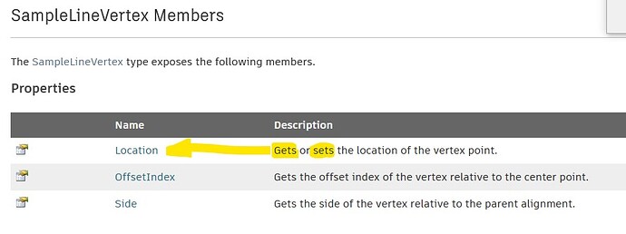

HI
GET SampleLineVertex FROM SampleLine
AND USING… Location
I don’t understand the input data of the node (Location and side) Could you give me example?
why output is bool no sampleline

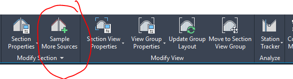

I want to add sources to section view

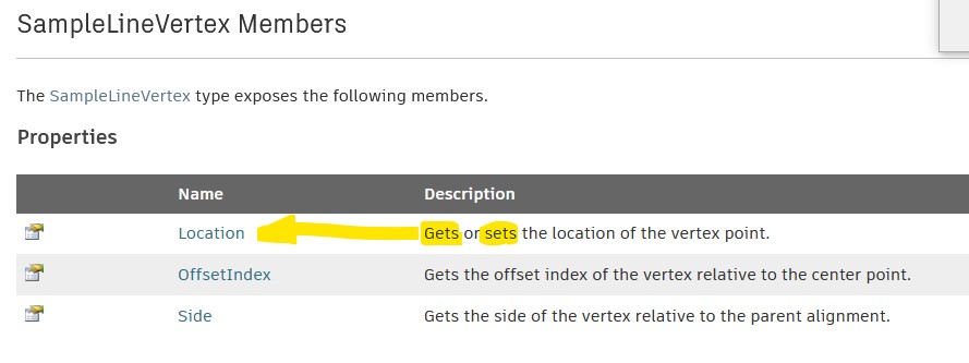

I want to use node setvertexlocation for sampleline in Camber package… I want examlpe with this node because there is error and I Don’t understand input in this node
is there simple way to add material list for cross sections
and add sources to cross-section don’t work with me
