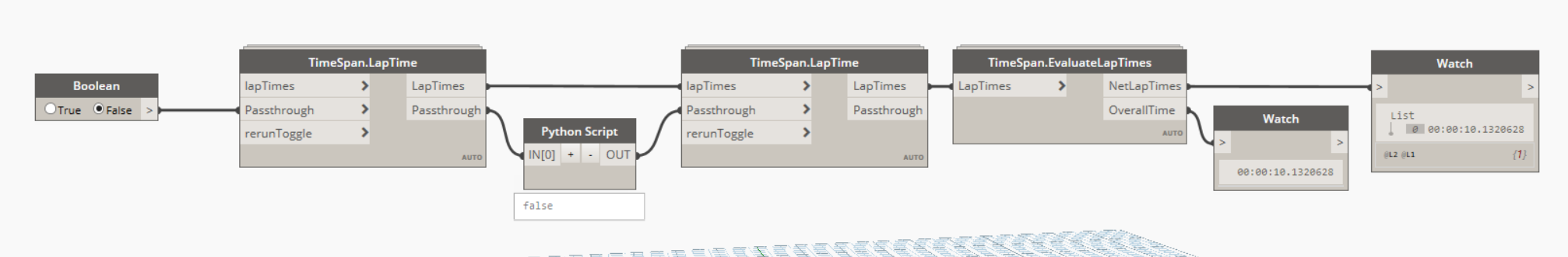

Not a great method as there is no way to know how long it takes to wright a PDF (depends on content being printed). But you could use pythons sleep function.
import time
time.sleep(10)
OUT = IN[0]
This will pause the script for 10 seconds (my input variable change as needed) and then pass the information input into the node.
The TimeSpan nodes are just to check that it is working. As you can see it took longer than 10 seconds to complete this very simple script.
Again this does not mean that the PDF will be completed after the given sleep time and it could also force you to wait longer as the PDF could complete well before the sleep timer ends.
