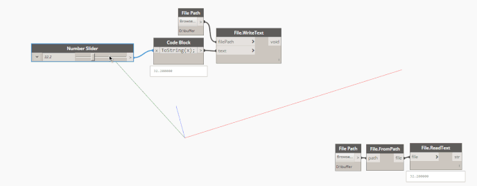

Seems like what you’re after is something along the lines of a class instance’s fields and properties that you can read from and write to. Design script functions don’t have any such “memory” however. Implementing such functionality and making it update dynamically is easier said than done. There’s a great package that can already do that, tho it hasn’t been updated in a while:
With a bit of creative thinking, you can make a “lowcost” version that uses files as buffers and the dynamic update functionality of the “File.FromPath” node, but you’ll also have to handle the serialization and deserialization of the data yourself:
@Dimitar_Venkov - what would you recommend to ensure that the write text always happens before the read text? I just built a test version which happens in the opposite order, resulting in a failure to read the right variable on run. It’s unlikely that it’d happen in a linear progression of graph development (you’d have written the variable before reading it), but something to keep in mind as I can see backtracking to re-work the nodes creating an issue.

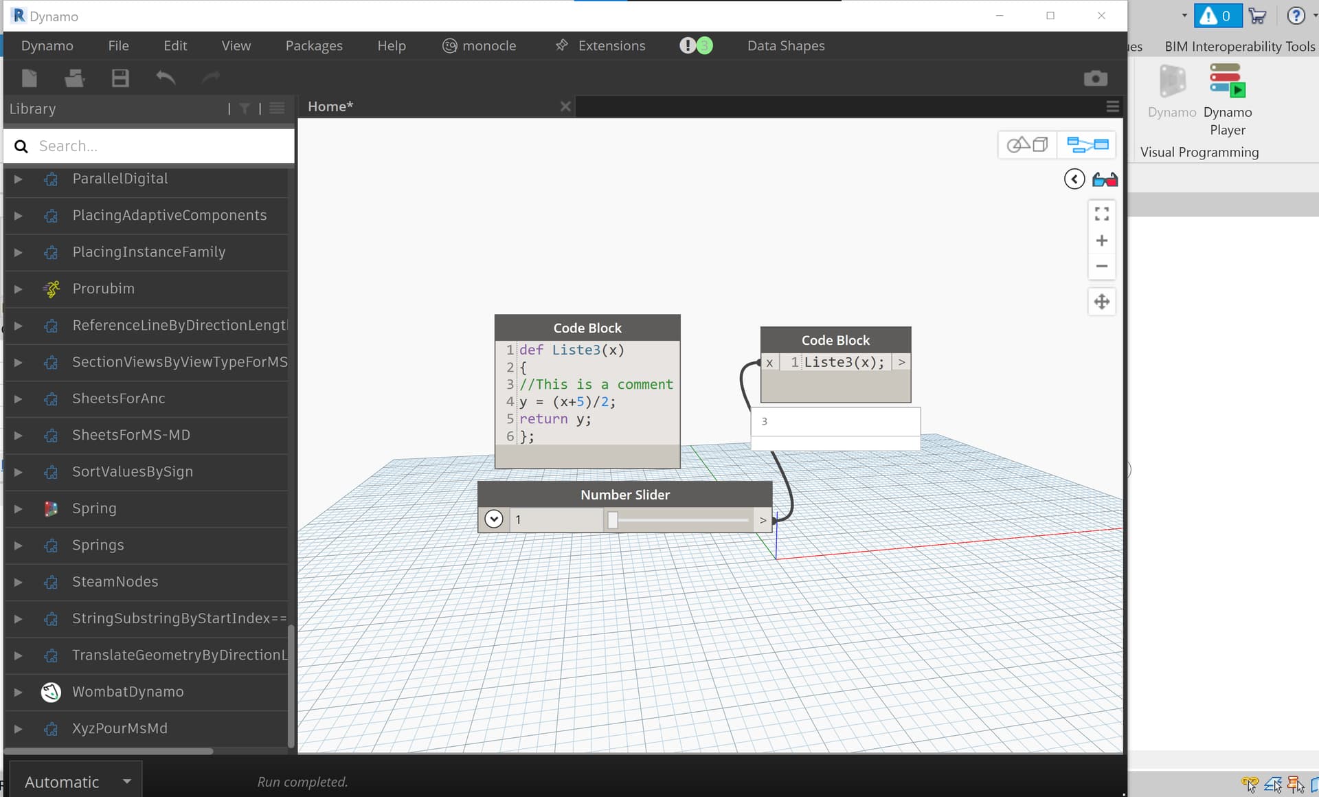

Your last node is failing as you defined v as an input for the var1 function, but didn’t give any inputs when you called var1.
