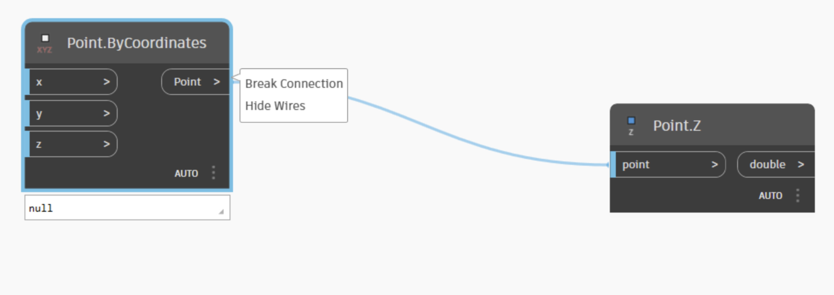

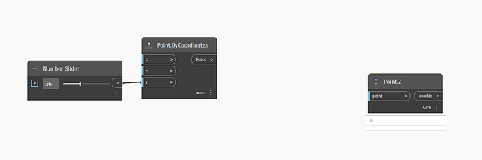

We don’t currently have plans to ship in 2.13 an extension that does this, but what we are planning to come out of the box is as follows:
  • Selecting a node with hidden wires shows a “ghosted” version of those wires, which you can interact with
  • Output ports will have a context menu that enables you to interact with the hidden wires (Similar to the on-wire context menu we are adding)
  • On-wire right click context menu enables hiding/showing of wires and breaking of connections
The extension is a good idea though…could be a great addition from the community? :wink: If not, we can evaluate how the above lands and see if it’s needed.
Screenshot showing a ghosted wire ad the right-click wire menu:
Screenshot showing the output port context menu for said wire:
