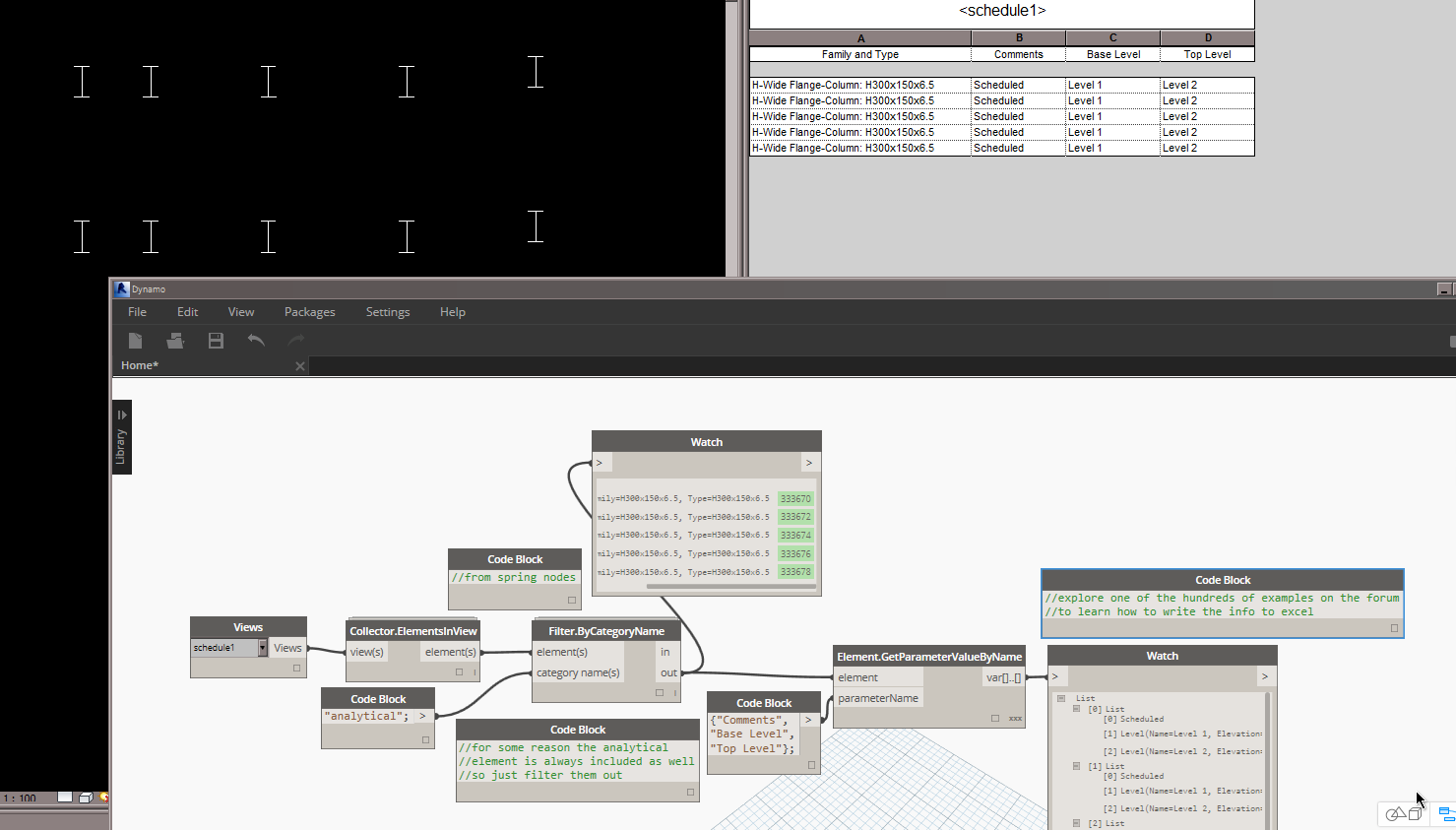

As Konrad explained, you’re trying to use the schedules inappropriately. However it is possible to at least re-use their filtering and save some time. A schedule view acts very similarly to other views. Thus the elements “visible” in the view can be queried. So instead of running a collector on the whole project, you can run it just on the schedule view:

Thank you for your example graph. By the way for the nodes “Collector.ElementsinView” and “Filter.ByCategoryName” I cant
seem to find them. Do they belong to a certain package?
Hi Eddie,
It belongs to one of my favourite “Spring Nodes” package.

I try the graph suggested above with Spring nodes. But it return a flat list with 1 dimention with random values from different data rows.
I notice that the entry parameter of the Filter.ByCategoryName is waiting now for an element object insted of element(s) like describe in this thread.
Is there any alternative or am i doing somthing wrong?
