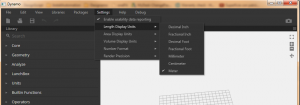

You can change units in Dynamo, go to settings and set your units for Length, Area, Volume.

if you are using numbers with the “numbers” node dynamo assumes you are working in decimal inches.
if you are using the unit conversion nodes everything should be in the units you choose in the settings.
(at least i think the nodes behave like that).
I myself multiply with 3.2808 to convert.
