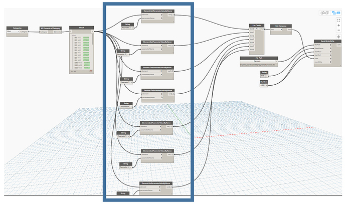

I’m starting on Dynamo ! I have to create 33 parameters for elements but it require a big list.
I’m looking for a solution to group “n parameter” with less blocs.
Have you got solutions ?

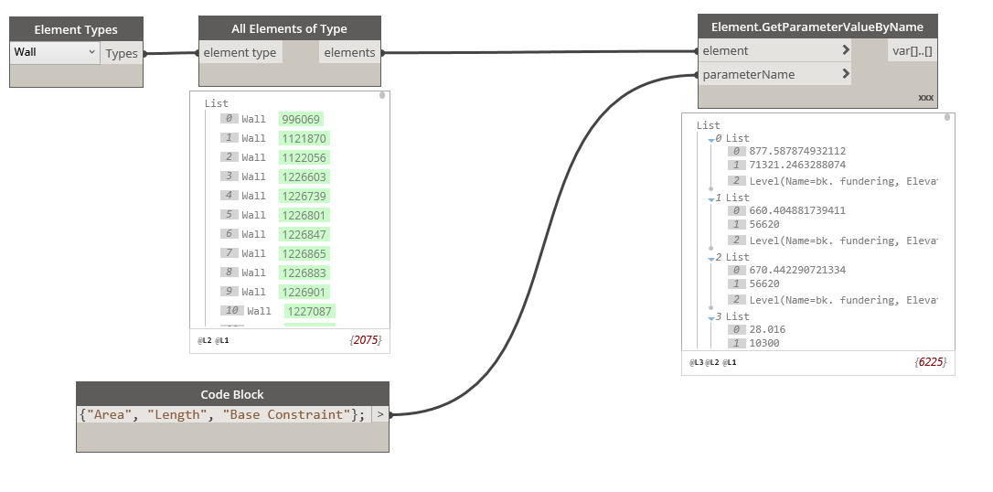

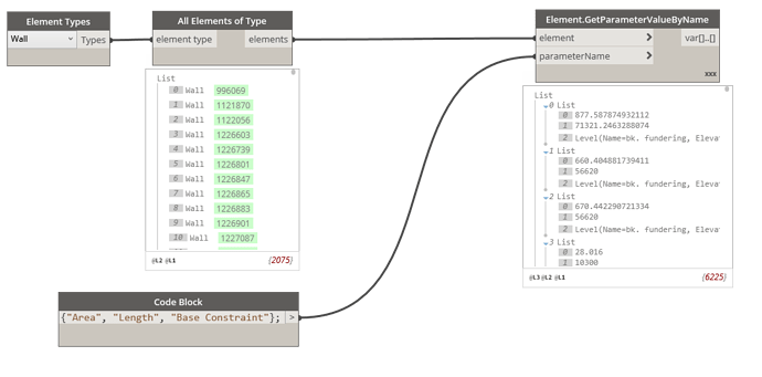

I think what you’re after is something like this:
Mind the crossproduct.
Otherwise set Lacing to cross product on ‘element.GetParameterValueByName’-node
@Jonathan.Olesen
LOL! look at our reponses at the same time. …

Thanks it’s perfect ! You’re awesome :wink:
