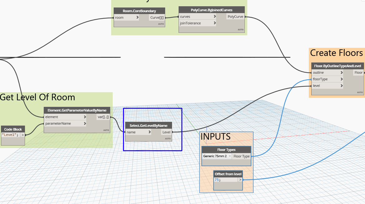

Now I am trying to do it so that the floors are made on respective level where the room is. Some error is coming. Could you just check this out?floor by room extent on respective level.dyn (20.4 KB)
and this is the error.
Some inputs are wrong, can you show the levels and expand the polycurve please?
Hey… I got it to work. Basically I had to call the levels from the selected level names.
