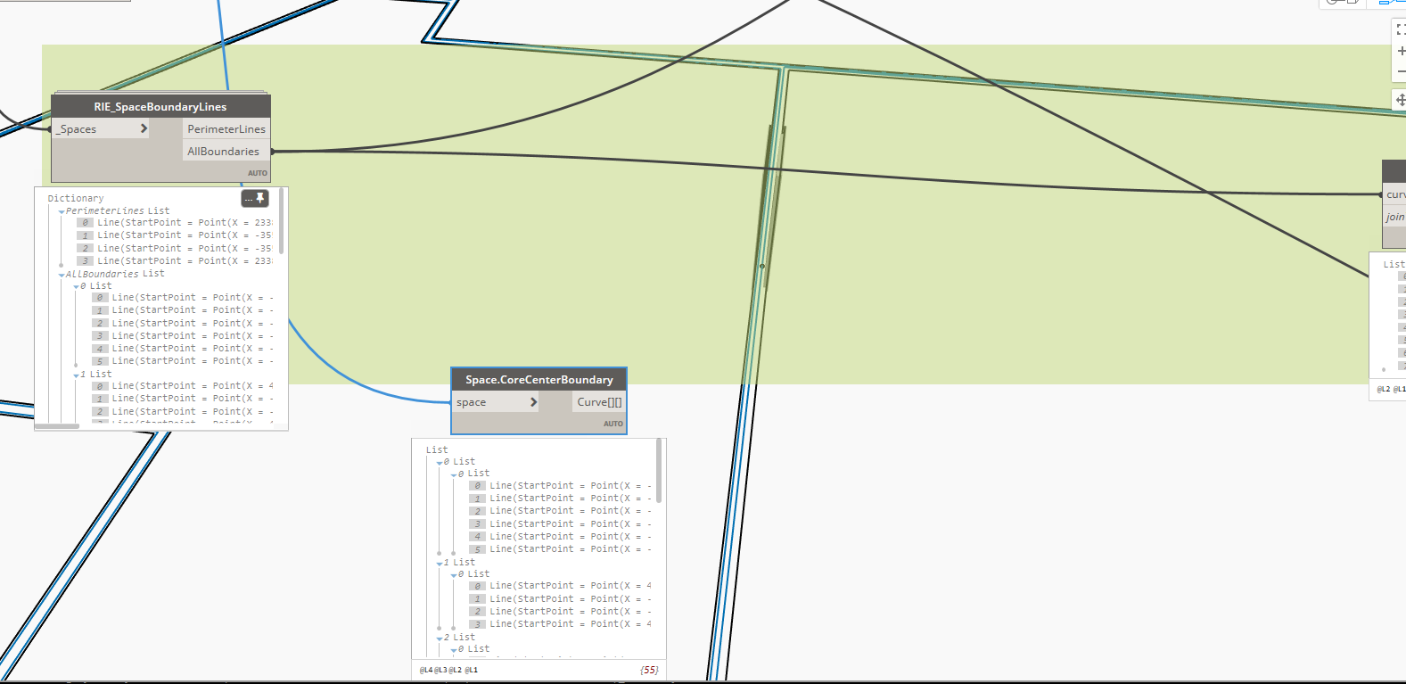

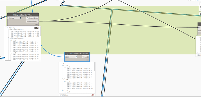

I use Space.CoreCenterBoundary node but output comes twice because I have 2 different walls and with different thicknesses, one in the model and another one in the link file, I need boundary comes from the link file only.

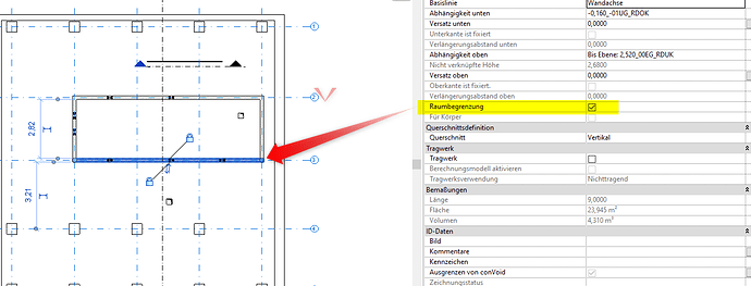

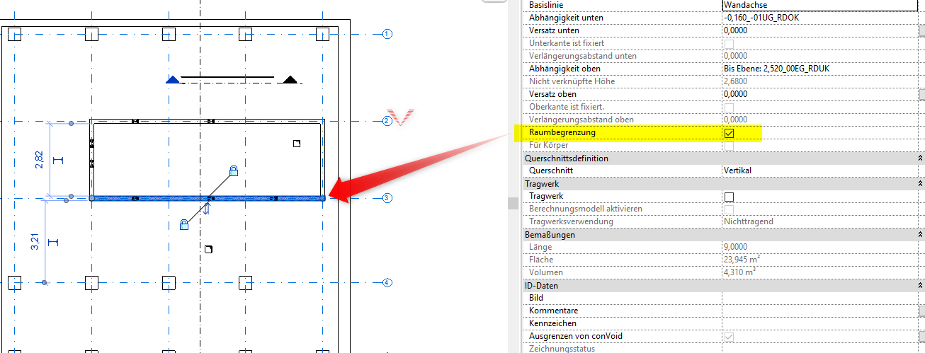

how I can deactivate the room boundaries in the main model ?

I know this one,I imagine that is another option
I try it with no luck same issue happened again
