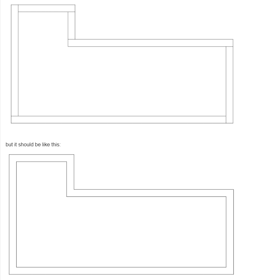

I managed to create a script that works! The only problem is that it looks like this:
Is creates a separate filled region for every wall instead of creating one single filled region for all walls.
Is this possible to fix somehow? :slight_smile:

Hi @didekalsan !
Did you tried PolySurface.ByJoinedSurfaces ?
Surface.Union (or something similar, can’t recall the exact name) will merge those surfaces into a single surface.

No I have never tried PolySurface.ByJoinedSurfaces before. I tried using it now but it gives me the same result:
My guess is that I’m using it incorrectly?

i think you need to use List.Flatten before the Polysurface node
I still get the same result. This is the script:
BEFORE the polysurface node :slight_smile:
(it will make a list of surface instead of a list of list, then a single surface))
Yes sorry my bad!
I get this error:
The node I was referring to is Surface.ByUnion. It will probably just do the same thing as the Polysurface node, so either or there.
