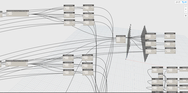

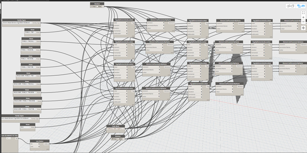

I am pretty good about leaving it in Manual mode, so that hasn’t been an issue. Here are some screen shots. The blue area below is identical to the grey at the top, just retrieving different columns from the excel sheet…
I am attempting to place embed plates in a precast concrete wall panel. currently I have each wall panel setup to run on a single script, but I am trying to combine them into a single script if possible or at least 2 at a time.
I have computed the XYZ coordinates for the embed plates in excel. so I am retrieving the coordinates from excel and placing them into my model. Then adding the elements to their various assemblies and tagging them in specific views.
