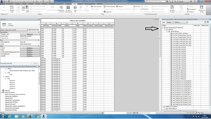

I have been able to create a schedule with the parameters visualized in the system browser and then, running a dynamo script, I could export those data in excel. However, the excel file visualizes me the pipings connected only, me I need the unassigned as well. So my problem now is, how to export the unassigned as well.
Can you provide a screen capture of your work or even upload it? It would be helpful to those that are willing to help to see where you are.
Hello Tom,
yes I attach it here. This is an example of my situation, where I have 37 unassigned elements in the electric system.
Thanks again
I succeded to export the mechanical system, as visualized in the system browser by making a schedule. However, I would like to know why the air conducts flow is not expressed in L/s. For example, take the first row of the Revit schedule:
(see red circles in my screenshot).
