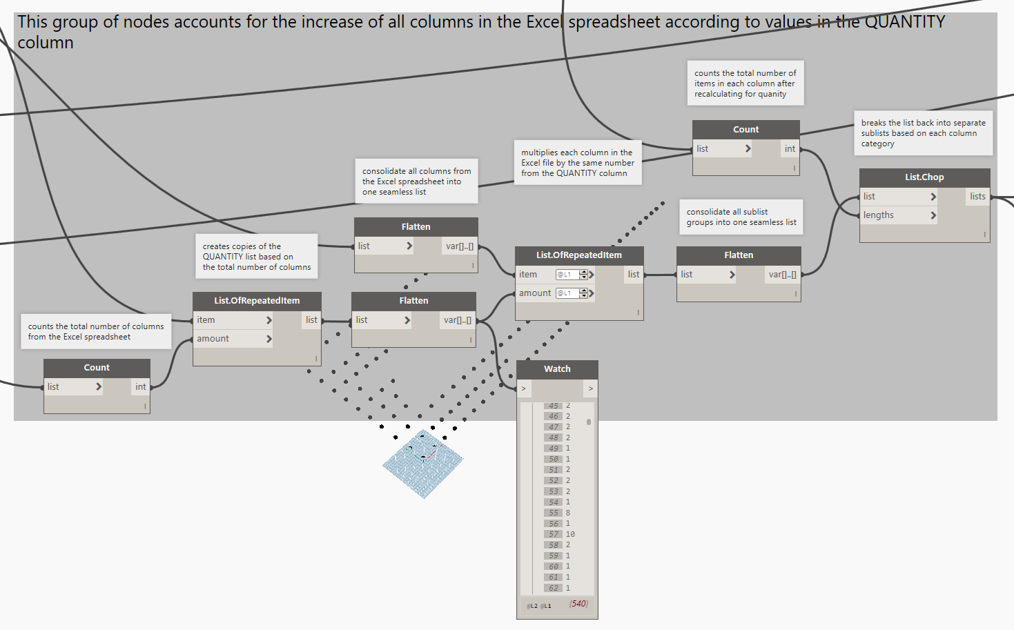

The first screen shot attached I’ve patched in a watch node and you can see the number of returned values is 1700 and change with loads of nulls.
The next is the exact same script with a working spreadsheet. Same column layout and naming, same values, everything the same as far as I can tell. Also you can see the list repeats, as it should, where the failing excel has nulls and then repeats. also, value count is WAY down.

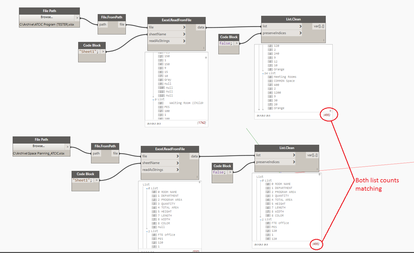

Could you also show us the list of values directly extracted from Excel (before the List.OfRepeatedItem node)?

sure!

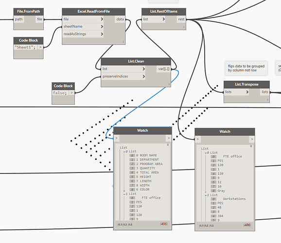

And I suppose you used an Excel.ReadFromFile node before List.Transpose?
oh yeah… it’s a whole process, again I can produce a clean result with a specific excel file. but I don’t know what it is that’s keeping that file clean. the “(TESTER)” file is the one producing the nulls

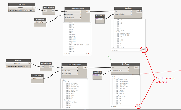

@aclark Try this file For Clark.dyn (7.4 KB)
@aclark - Can you tell me what excel version you are using?
so this is awesome, and interesting… when i run my functioning excel file i’m getting 550 values returned and your cleaned versions are returning 495… This is awesome, let me patch this in and see if it cleans up the issues.

You guys!!! you did it… I patched in the list.clean node that @Kulkul provided and it works!
