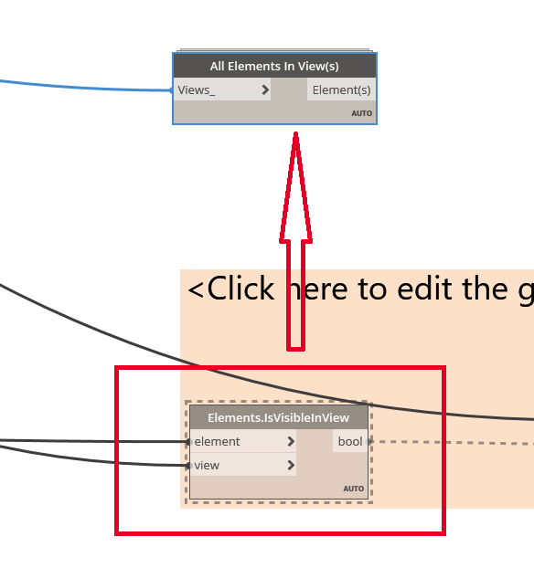

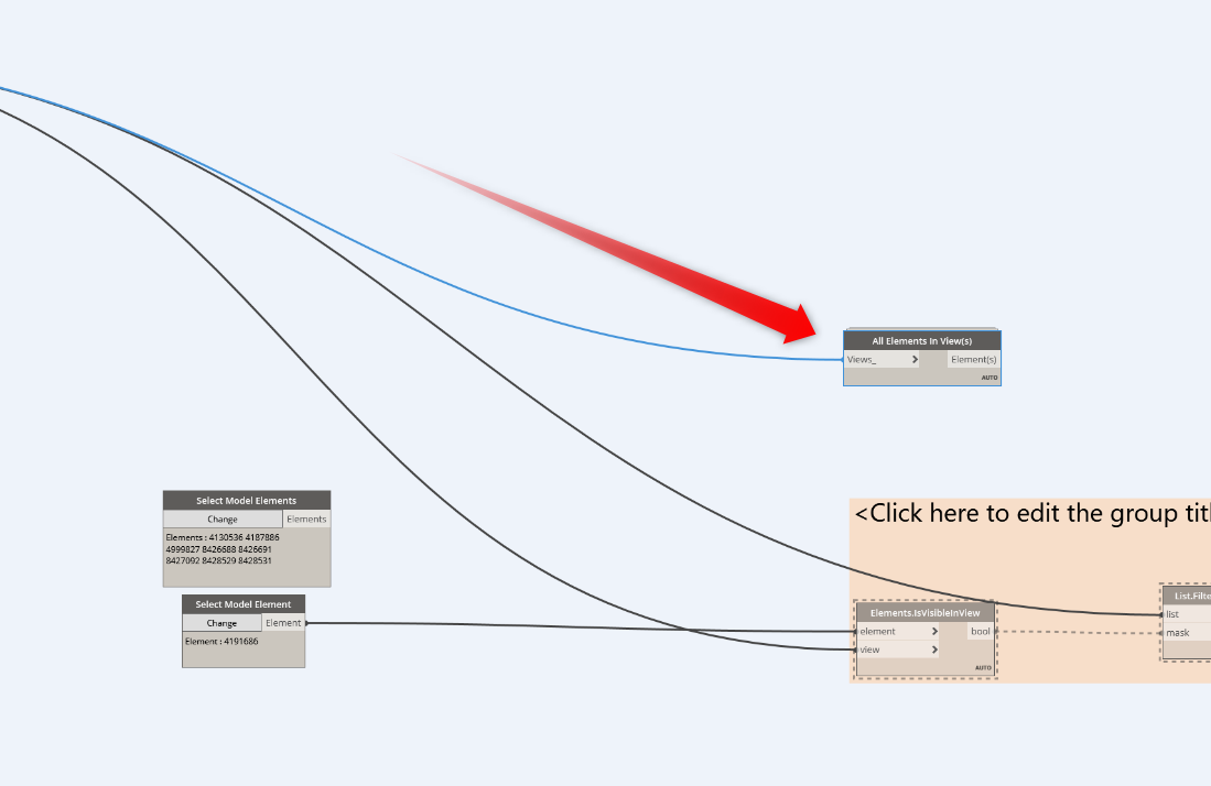

I completed my script but it is too slow. I think the problem is the node ‘Is visible in view’ (archilab).
I guess that as there are 700 views in my model, it takes a long time, 15 minutes, to collect the elements in each view. I am also using the node ‘All Element in View(s)’ from Data Shapes.

@JC.Moreno ,
get rid of this node!
HI @Draxl_Andreas,
This node is here because I was trying to find and alternative to the ‘Element.IsVisibleInView’ which is too slow.
My first suggestion doesn’t work.

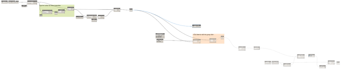

Please find in attached the dyn file.
element_in_sheets_v1.dyn (51.9 KB)
