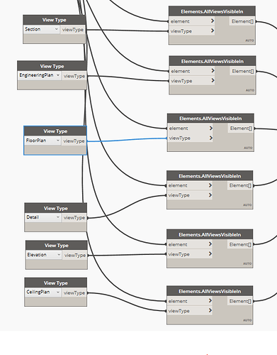

Hi Vladimir,
It seems that the time has been shortened by half. I assume this is because it is only looking at the specific view types. However, these are the view types we use.
I imagine these nodes search all types of categories. I would really only need it to look for modelling categories and not annotation categories.
