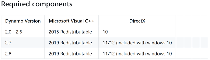

Do you have all Required components?
yes, i think so as 2.7 sandbox is running flawlessly

My suggestions came from the GitHub Dynamo wiki page.
Maybe i skipped one option.
marcel, thank you for your reply. i followed the hints in the wiki.
