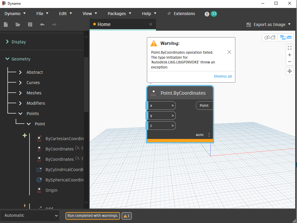

Hello! I´m like really new into this and the first thing that pops up is this same error. Please help.
I´m trying to use simple geometry to learn and follow the steps just like the tutorial videos.
This is how it looks running Dynamo built in Revit 2021 but…
This is how it looks like while i run Dynamo Sandbox.
I’ll appreciate any help because I can’t go on with this unsolved.

Well thanks! It’s changed at least the sign:
But still gettin an error.
I don’t know what else could it be.

can confirm what @jacob.small has just posted, it is a matter of pairing a DynamoSandbox version which calls a matching libg.dll from the Autodesk product you’re using it with. In case of Alias, this has been upgraded between 2022 and 2023 for instance.
The error you’re currently getting indicated that libg.dll is indeed found, but the call to the invoke function in the Point class fails. As a starting point, you can initiate Dynamo from within your Autodesk app, and check its version number. Pick a matching DynamoSandbox version, use the gp flag, and it should work. From there, you can test with higher DynamoSandbox version numbers until it starts failing. With each update to your Autodesk product you can try if newer DynamoSandbox versions work.
