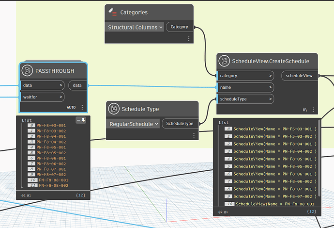

Dynamo alters direct input at will?!
How is the string changing? It is directly linked in the schedule creation node. There should be NO possibility for it to alter. This is freshly started revit, fresh dynamo and this is the first time running the script since revit boot.

Different project, different graph. Once again similar stuff:
Switches at that exact substring length.
The input and schedule creator are separated by PASSTHROUGH node but nothing else as before

2)SCHEDULE master V4.2.3.dyn (618.5 KB)
Here’s the graph. If you also require the project I will send it privately since I am not sure I am allowed to share projects publicly.
The graph seams to retain memory of previous execution. The revit has been closed, computer rebooted entirely, yet when I open the program and run it for the first time after restart in this step it displays PRE-RESTART RUN DATA in schedule creator node despite it being fed different data. I have no idea how it’s possible.

I found that deleting that node and replacing it works. For one run - then I have to redo the same thing
