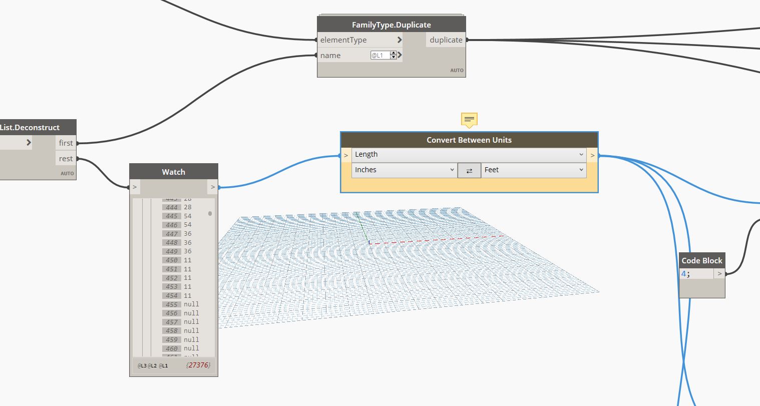

Put a watch node on the data coming into it. My gut says you have a null or other data point that doesn’t belong.
You’re right. Anything after 455 has a null value. Any idea how to fix it?

I’m guessing that your parameters are all set to take doubles as you’re attempting to convert data types. I’m also guessing that you have a string (word) in that data set; perhaps one representing a number (ie "1" instead of 1).
The Object.Type node should confirm. Numbers should be either integers or doubles. If you have a string you’ll either have to clean the excel, or convert them into numbers with a String.ToNumber node (if possible - not all strings can be made numbers).
The first error is being caused by you inputting strings into the unit conversion that only accepts doubles or integers. So you will need to rework your input list to remove those strings. Due to strings, the unit conversion is returning nulls for those items because it can’t convert them and in conjunction throwing the error. When when you inserted the list clean after the unit conversion node, you basically cleaned out all those nulls which in turn removed the error being reported by the set parameter node.
Thank you both!! @staylor @jacob.small You were totally right. It was reading strings into units and showing them as null. What I was doing wrong is that I was kind of bulk converting all of the lists together. I had to add multiple ConvertUnit nodes AFTER each list (that are all doubles and have no null values) rather than one node before . Hence the result. Thanks again. You are the best!
