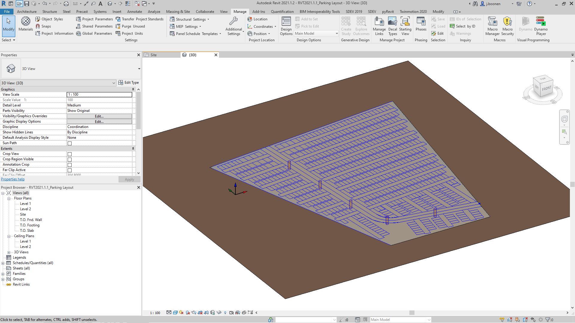

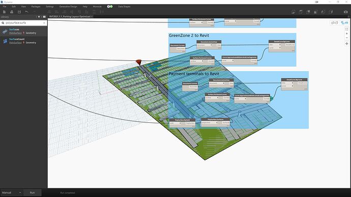

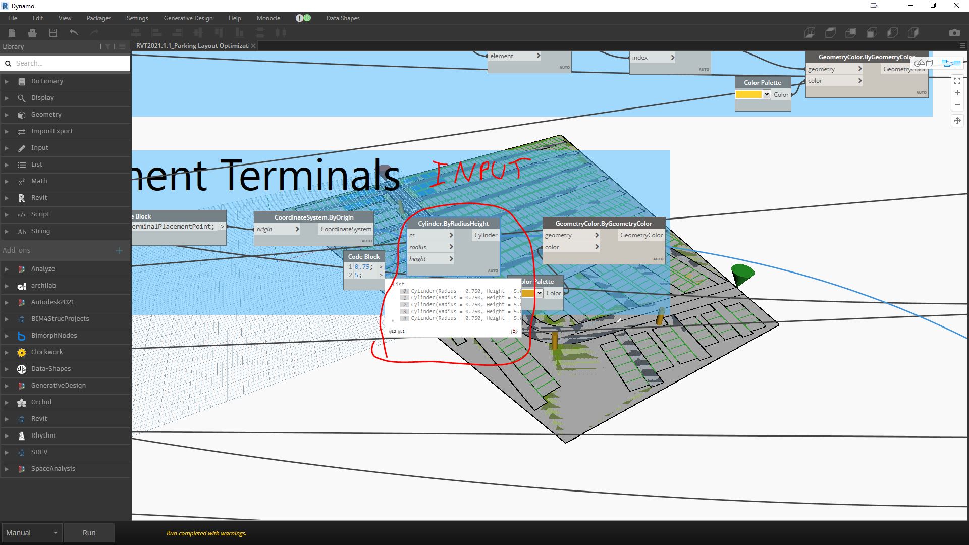

I would like to display the cylinders on the “Site” in Revit (see fig. 2 ; red indication). However, I get the above message. Probably because I make a “Cylinder” not equel to a “Surface”. Which node should I replace “Surface.PerimeterCurves” with (see also fig. 1, fig. 2 and fig. 3)?
Fig. 1
Fig. 2
Fig. 3 (input “Surface.PerimeterCurves”)

Hi @j.boonen !
Did you try PolySurface.BySolid, then PolySurface.Surfaces ?
@Francois_Labonne
Thanks!
Problem solved!
