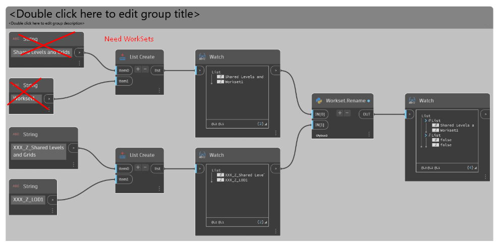

Hi pyXam
I have managed to find the time to keep going with this script and thought I’d give you an update. I have managed to create the scripts and learnt how to import the code into a Python node.
The script to create new worksets is working great, but the worksets being renamed are returning false values. I have attempted to change the way I am inputting my values with no luck.
I am planning on allocating time towards enabling the worksets soon.

Hi pyXam
Apologies I will export an image of my graph later on this morning and update my post.
Hi @pyXam
I’ve exported an image of my graph for you to check. The Python node is running the code provided, and although Dynamo shows no errors, the values are false.
Please let me know if you need more details to diagnose the problem.
Note: I’m just starting my Python journey, so I hope to resolve these issues myself soon. Thanks for your help and advice so far.

Hello!
Sorry, I am at a very bust time in my life at the moment.
Best at a glance, is that you are using Cpython3 as the python engine and Crumple package was written in Ironpython.
So.. If you have not installed the Ironpython2 Package from the dynamo team, do that.
And then right click on the python node and change the engine to ironpython.
I Hope that solves.
the IN[0] entry needs a workset list (not strings)
