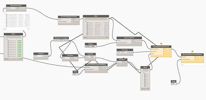

Hello. I also would like to create floors to room for all levels. However I only got floors at level 0, whatever level I chose. Can anyone tell me where I have missed in the attached notes ?
Hi @helenaSQQ8Q
You could use “List.Combine” node. Something like this might get you.
RoomFloorLevel.dyn (27.7 KB)
Thank you, it works excellent:))

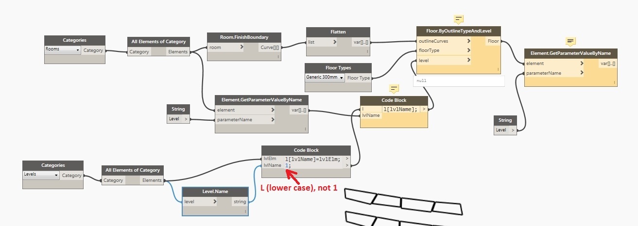

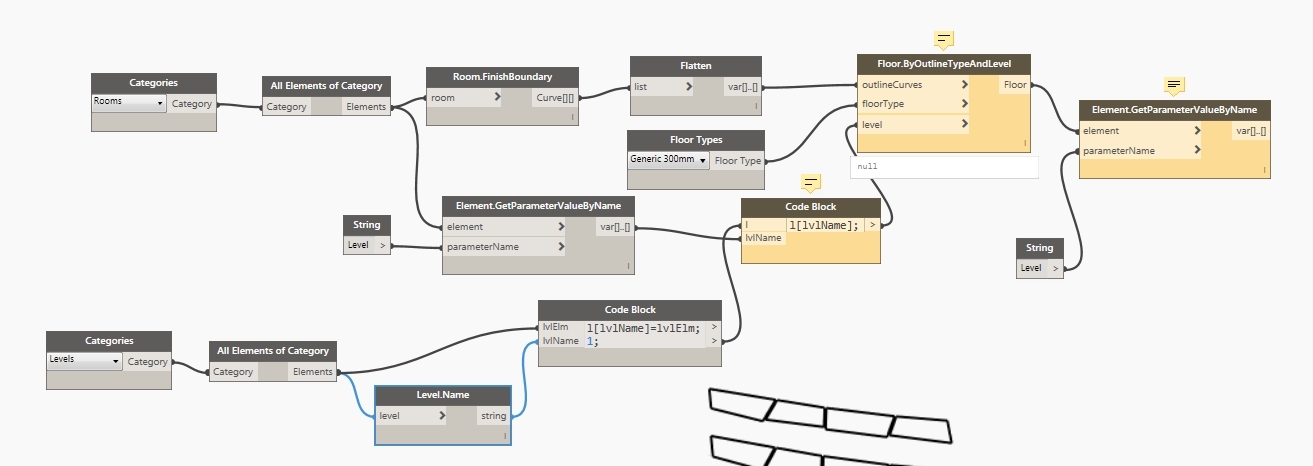

Hello Vikram. Thank you for trying to help. I tried your notes, but got error at the second “code block”, attached here. Do you know why?

@Vikram: I still got errors at the last to notes. Do you have any idea
@Kulkul: your notes work excellent, however I would like to build floor at severy levels, without make too many level notes. Can you help me? thank you.
