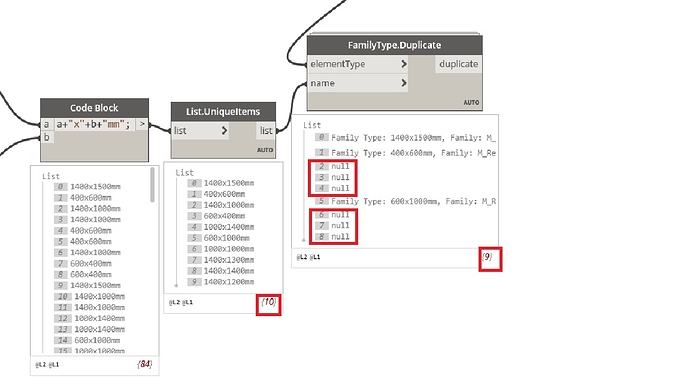

Hi,I’m New to Dynamo, and I want to create column types through with the list with type names, this is my approach using FamilyType.Duplicate, but it didn’t work quite well, any suggestions, thanks in advance

Thank for the help, I was busy these days, I’ve tried but it Just give me one type from the listCapture-01
I’ve tried using the Family Types node it gives me null, any suggestions? thank in advance

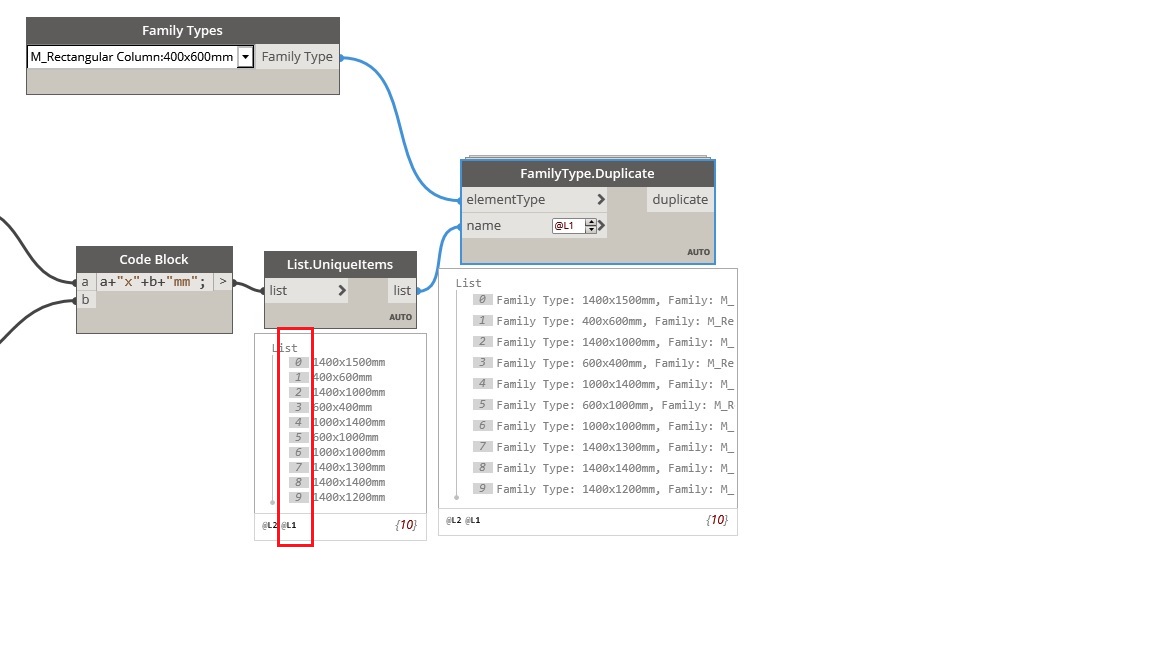

You need to set in the node FamilyType.Duplicate the node input name List levels at @L1
Knipsel
http://dynamobim.org/introducing-listlevel-working-with-lists-made-easier/

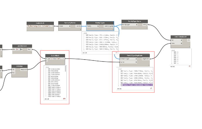

and check if those family types already exist in Revit
It works!!! Thanks man, can you tell me why it need to use levels? Very Thanks
It is because the items wich you want to use as input are at list level @L1
