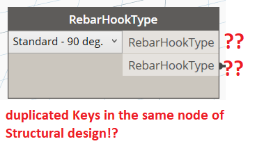

when I opened the dyn file I found a duplicated keys of the nodes RebarbarType and RebarhookType I don’t know what this is due to?? :roll_eyes:
duplicated nodes
Please check below the corrected files that should work
