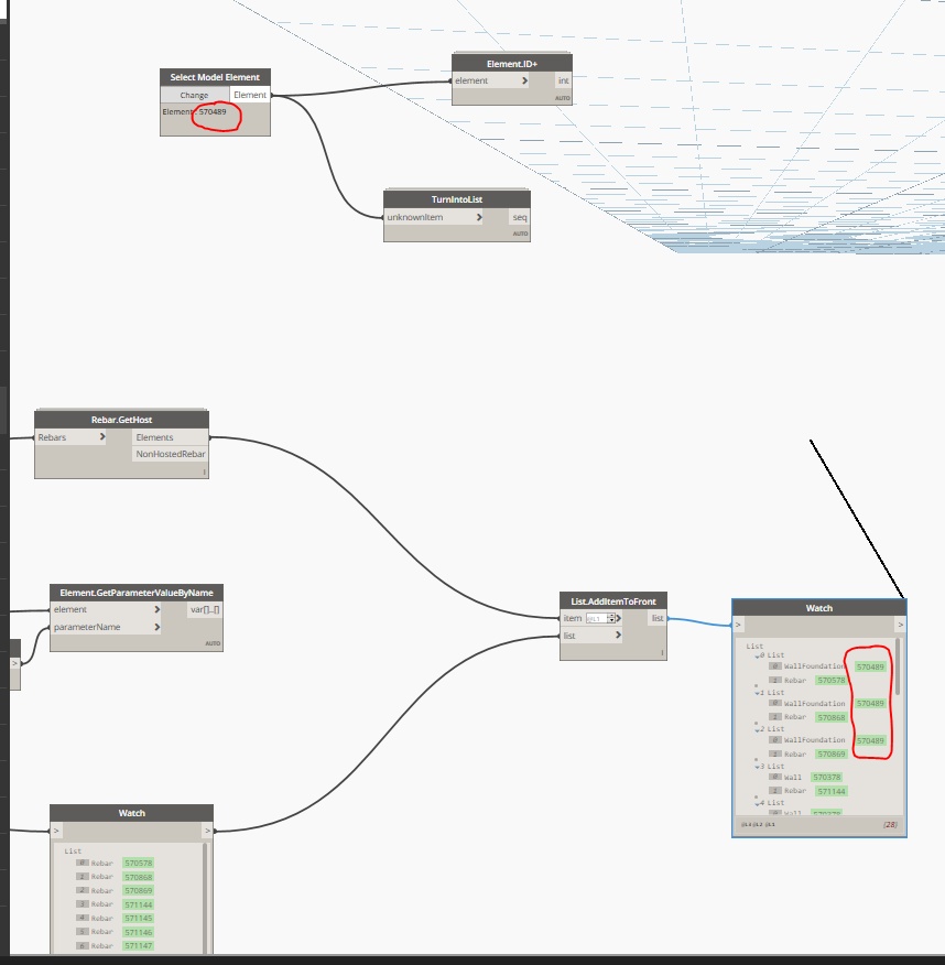

I tried going a different way and I think I got a little farther, but have hit another wall. This is what I have so far, please correct me if i am wrong, I have selected the rebars in the project and I have selected the elements hosting those rebars. I then filtered the host list down to the specific element I am interested in, but now I have two lists one of rebars and one for the host and I can not think of a way to put those two lists together. I mean I can see the index for the host list IS the rebar, but how do I inflate the list to show that index is actually a rebar element? any and all help is appreciated. I have included my updated graph and revit test file.
Mike

I’m not sure if I am making any progress or not. I seem to keep hitting a wall. Anyway, I hope someone out there can shed some light on this for me. I have my list of rebars and hosts grouped together, but I can not figure out what kind of filtering or sorting node I need to trim the list down to only the host item i am interested in copying the rebars from. any suggestions are welcome. Thank you for reading. I have attached my graph.
