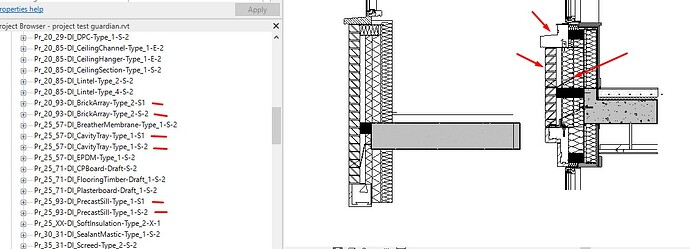

Hi Jacob, thanks for your message, I will try to explain both:
1.I dropped the item here cause it is a Revit issue so I thought about asking the community if via Dynamo/Revit API could be a workaround to it.
2.The end goal is quite simple if you have family named a in project a and you have another family named a in project b when you copy paste the family from a to b you would expect Revit to update the family and not append a suffix to the pasted family to avoid conflicts. The main issue we have is copy pasting Detail Groups across projects with Detail Items, if some families exist in the destination file instead of updating them create a bunch of duplicates.
It is quite frequent to end up with double the number of Detail Items, and within groups so replacing without losing annotations is a big thing.
Image attached to viz the issue.
