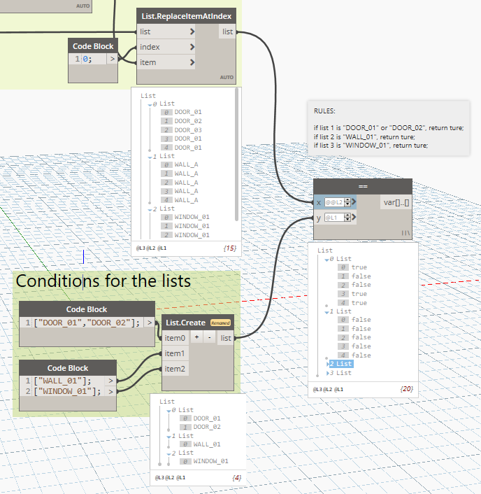

Hello ,
A brain burning question for you. Tips are very welcomed.
How to compare list with multiple structure?
I don’t understand the second condition “WALL_02”, it seems like this part didn’t work at all.
ListTest.dyn (28.1 KB)

Doesn’t it work if you just change the y input to @@L2? Or could you include the exact desired output?
Is this what you are aiming for?

no, if I do that, the result lost the data structure.
Exactly !

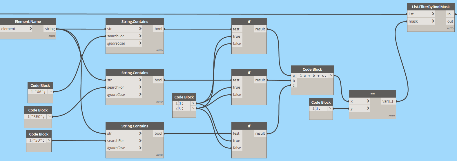

Yes, it can be one of the solution but needs to use boolean AND / OR to get the result.
In terms of advice, I would say; avoid creating complex list-structures and focus on getting easy-to-manage single lists of data. If you ever have to append your definition, it will make things much easier for you, or for your colleagues. I would focus on getting doors into one list, walls into another, windows into a third…and then dealing with those lists individually…especially when you want to start sorting them. The community here is (almost) always happy to help.
In which list? I typically use the “IF” node as AND/OR Gates.
If true, then true = 1 and false = 0
then I add those together in order to filter on AND / OR Conditions.
For “OR” conditions, only one condition must be met, and therefore the sum only needs to be greater than 0.
For “AND” conditions, I can set two, three, four, five different conditions and the result must fulfill all of them; thus the sum will be either two, three, four or five respectively.
Here is an example:

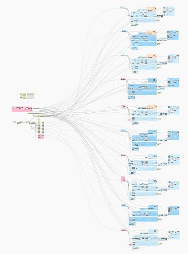

When I need to script something complex (like what you are trying to accomplish) I typically break that down into smaller individual scripts. These scripts are then numbered to run them in a predefined order.
Trying to create one script to do 20 things is much more difficult to create, troubleshoot and adjust than breaking that down into multiple smaller pieces.

I would recommend starting with one model type (for example architecture) and one category (for example, doors) and creating a template from that. Don’t try processing complex lists with multiple lines of data; build one “line” of data-processing and then copy-and-swap the differences out.
The major drawback to this is obviously, making corrections or adjustments to the scripts. It’s a real issue, so try and get one script working as elegantly as possible. Here is an example of a relatively complex script for processing technical openings:

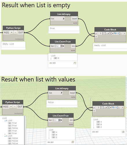

Thanks to @AmolShah the whole process almost works correctly. The last issue(I hope so) is to deal with Empty List. I don’t know how to tell python, if i in IN[0] is Empty List, don’t pass anything because the next node will produce a 0 which increases the list length.
In summary, after this script finish, I will rethink the analysis process and make another version that each script do simply process individually. 0_o

@Congzheng You won’t need a new Python node for that.
Try doing something like this:
[[],y][x?0:1];
Oh, that is so nice. Very easy to understand.

Yes you are right. If node only works with simple list. Finally I abandoned If node for this case.
I’m quite curious, why If node didn’t work in this case? if “test” receive “false”, pass the data from “false”, non?
@Congzheng When the list lengths of true List and false List are unequal, the If node likes to match the list lengths to the minimum number.
In your case the length of List.Empty is 0 and of List [2,0,1] is 3.
But since minimum length is 0, it reduces the List [2,0,1] to List.Empty and outputs that.
