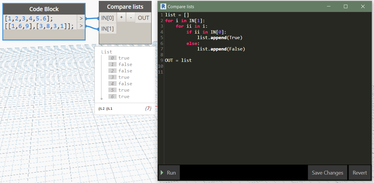

There are multiple ways to approach this process! I personally avoid using boolmask/anytrue methods because it uses an excess of nodes that can be easily replaced with a simple python script. Not sure exactly how you want your data outputted but this is a pretty simple idea you might use.Capture

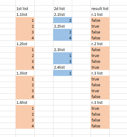

As far as I understand, that’s right, but for some reason your script doesn’t do that in my case. So I’ll show what I want to achieve lists.xlsx (9.0 KB)
