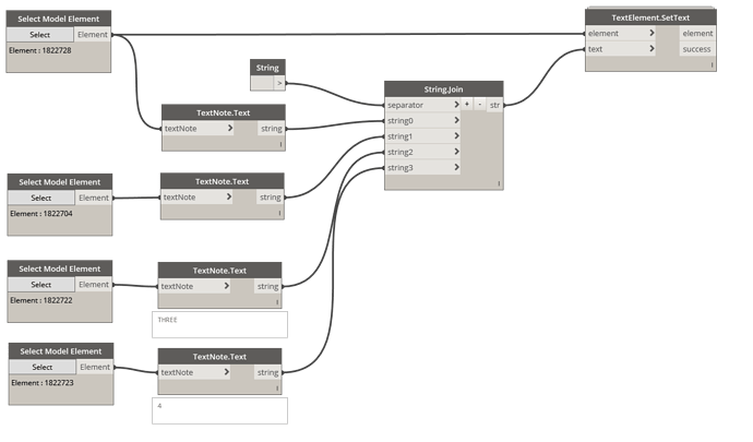

Is there no way to just pull the info from one text box, add the info from another text box, and then put them together in a new text box?
I downloaded Springs and that has some helpful nodes. Thanks!
@slipstream no that is certainly doable, using TextNote.Text, String.Join and then TextNote.ByLocation.

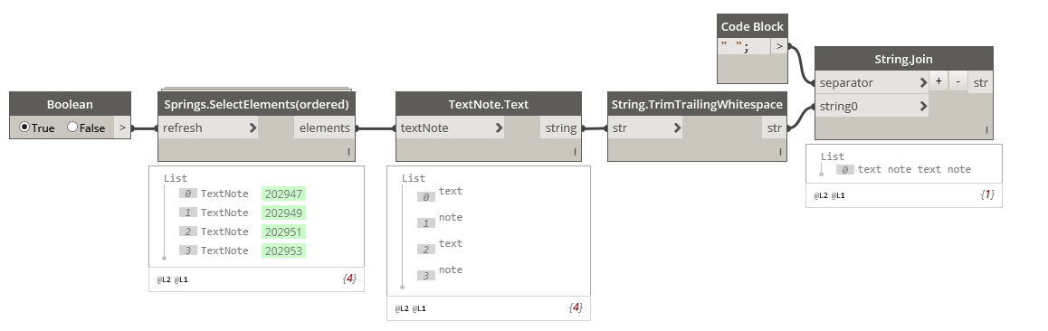

Hmm I’d throw a String.TrimTrailingWhitespace node after your string outputs and see if that does it. You can use List.Create to connect your strings, and then String.TrimTrailingWhitespace after the list, and then connect that to String.Join

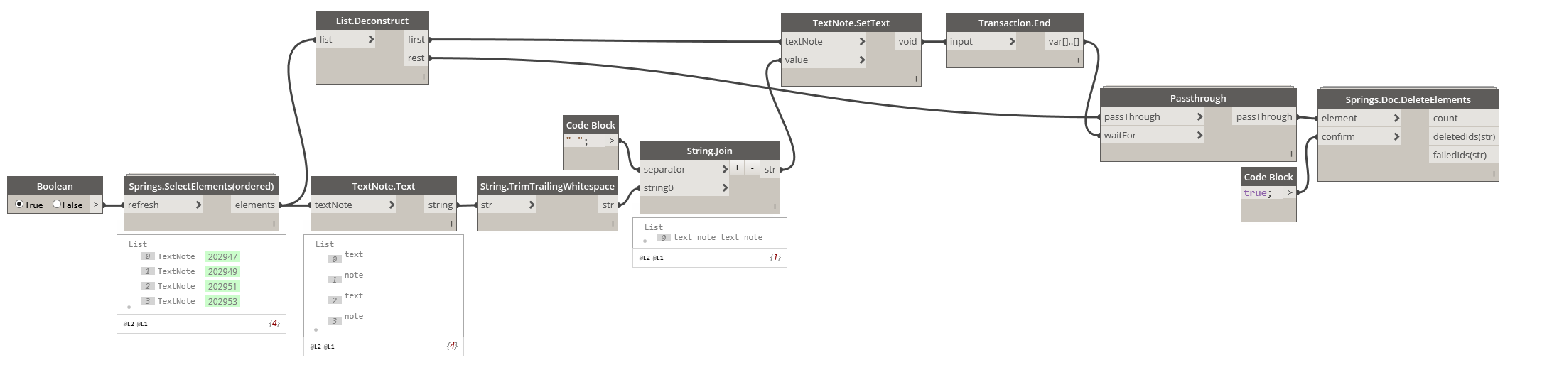

I would suggest trying out something like this though, so the graph could easily work with different amounts of text boxes:
(Just set “refresh” to false so you don’t have to repick the same text notes each run as you get the graph in fully working order)
That worked beautifully, thank you! And dang, yours is so much cleaner than mine!

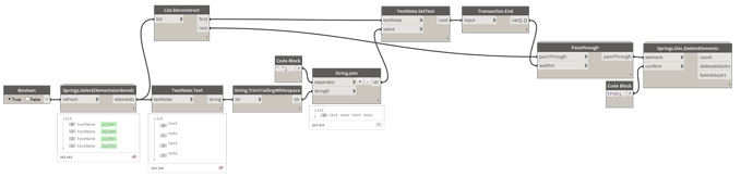

Also, how would you delete the obsolete text now in your example?
No problem! Generally, its better to process things in lists if they’re all going to undergo the same function at the same time :slight_smile: Here is how I would delete. The Transaction.End and Passthrough node are so that the new text value is set before the remaining ones get deleted, otherwise things would happen simultaneously and the text would not get set properly
Ah, thank you. I was basically going to set up the delete elements node on the other end with another instance of the select elements node and re-select the ones I wanted out. Yours is much more elegant and less likely to cause unintended deletions.

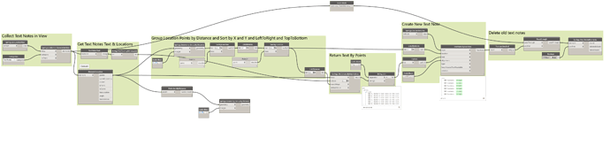

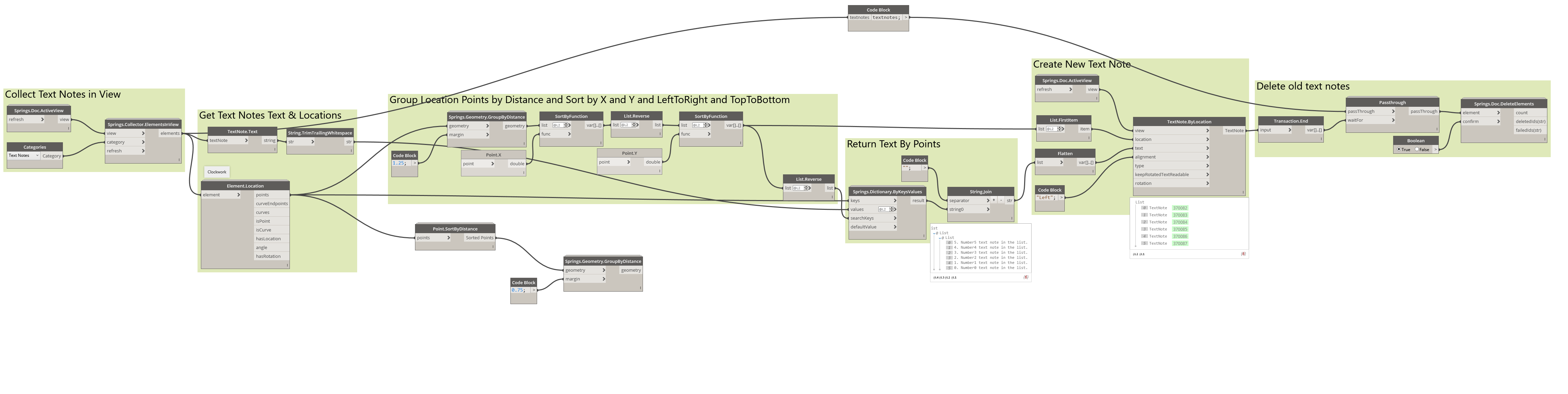

@slipstream When I first saw your post I had imagined something like this (collect text notes and group by their location points)

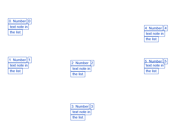

It works, but unfortunately it would probably fail in most conditions depending on how the text is broken up and how far apart separate sentences are. I only ran on this set up:
and it failed if text 1 and 2 or 4 and 5 were any closer together than they are now, haha.
Maybe rather than collecting all text notes in view, what I did above can be used with a “Select Model Elements” so you could quickly marquee select the sentence text notes that you’re processing that run, rather than having to pick them in order each time

When passing the ‘rest’ list from list.deconstruct to passthrough it only gets the first item in the ‘rest’ list. How can I make it do the delete element function on All the elements in the ‘rest’ list?
