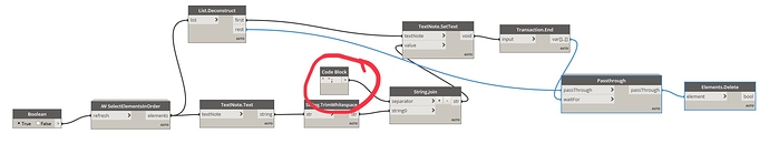

Hello Jacob,
Thank you for your response! I think I wasn’t clear about an issue I encountered.
What I am trying to figure out is the opposite of what you suggest: I want to take multiple lements and join them into a single multitext element.
First png file is a script I found by @awilliams. That script allows to go from 1 to 2 (see second image).
In order to get from 2 to 3, I need to know how to jump into new line.
Do you have any ideas?
Thank you in advance!

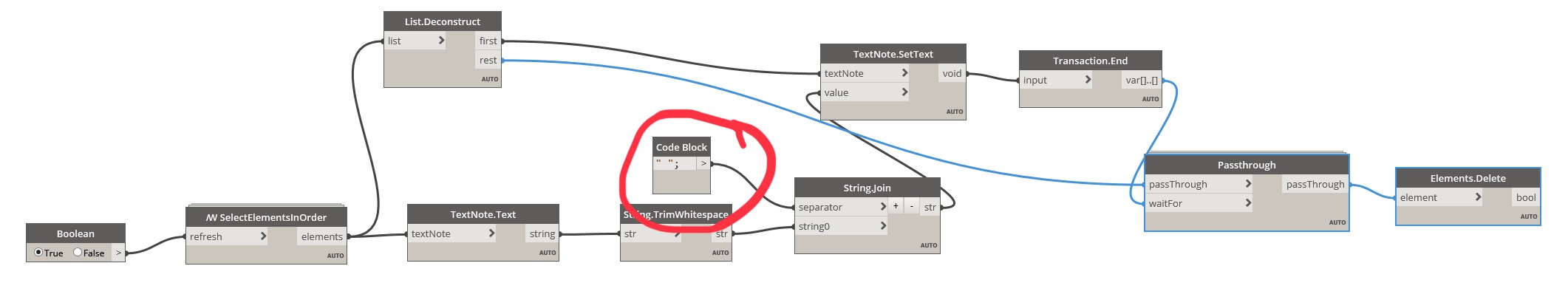

Gotcha.
In the graph, change the node I circled for an actual string node.
Set the value in the string node to an new line character (return or enter on your keyboard).

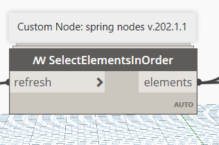

HI what package is the SelectElementsInOrder node came from?
If I am not mistaken that is from Springs. Update th package and check carefully. :slight_smile:
thanks @jacob.small, I’ll go check…
EDIT:
updated my package but still cannot find that node…

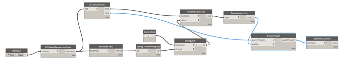

Jacob,
Thank you very much!
Solution is so simple:)
Hello!

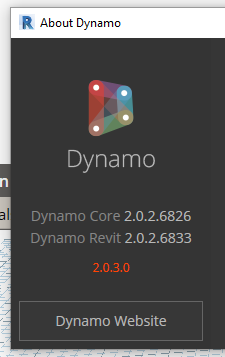

Revit 2019.2
Not sure if the node is not compatible with Dynamo v1.3.4, i downloaded the latest version but its not appearing in my packages panel, but its there in the package manager.
I tried to open the dyf file but says it’s corrupted.
I see two options for you:
  1. install Dynamo 2.0
  2. install previous version of springs (image from GitHub)
Thanks, found it. I will try to recreate the graph and see if it will work for me.
how you make selectelementinorder node block?
It’s from the spring nodes package.
