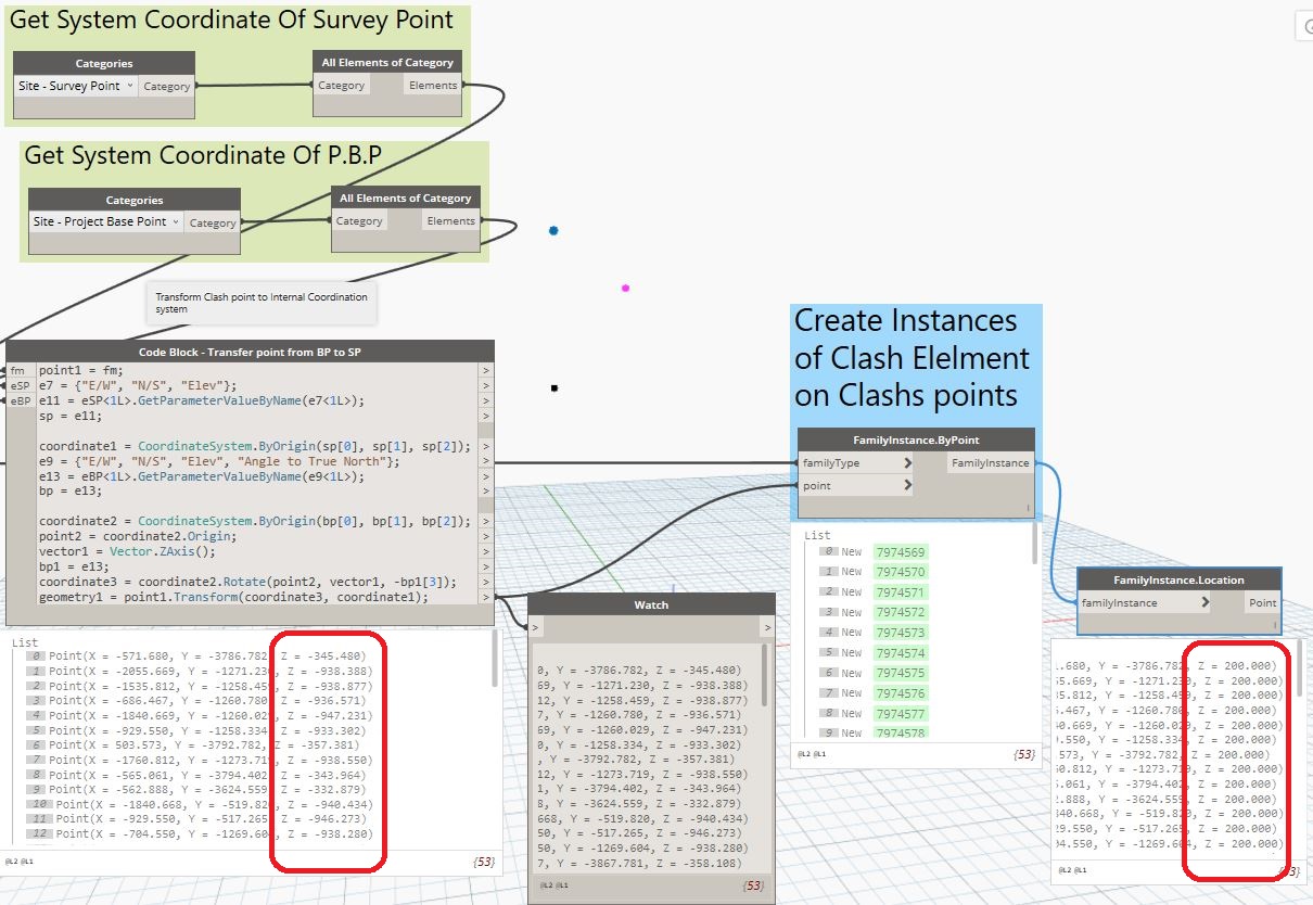

I wrote a script to generate clash spheres from NavisWorks report into revit model. Here I attached the part which takes the points data that read from XML report ( converted to Excel ) and do transformation from project base point to model origin.

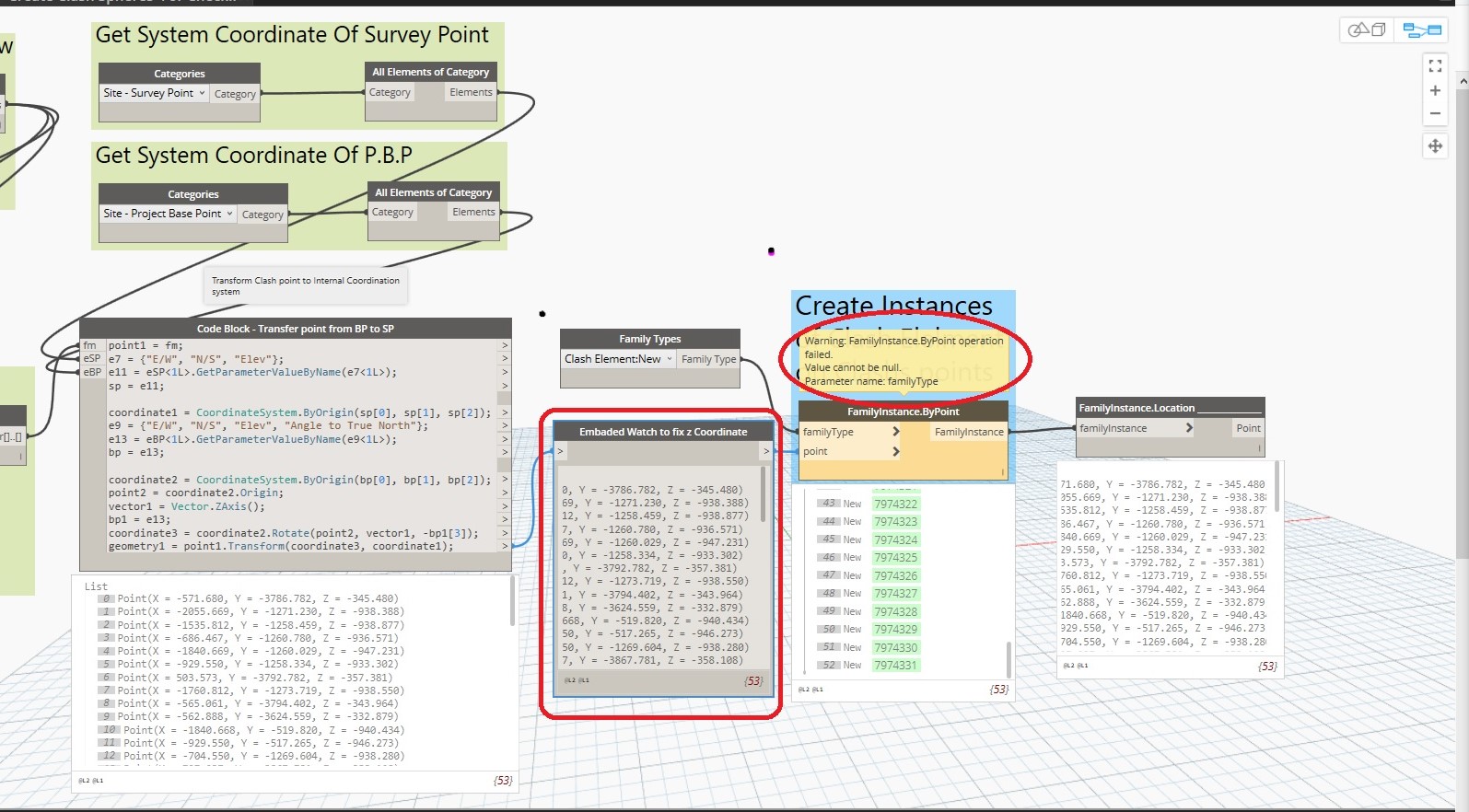

The problem is that the Z coordinate which transfer to node:
“FamilyInstance.ByPoint” interpreted wrong and the instances were created not in right Z coordinate. I have to say that sometimes the data is read well and I get the right clash spheres location.
Here is an example:
Is anybody can help me understand what is wrong with this code?
