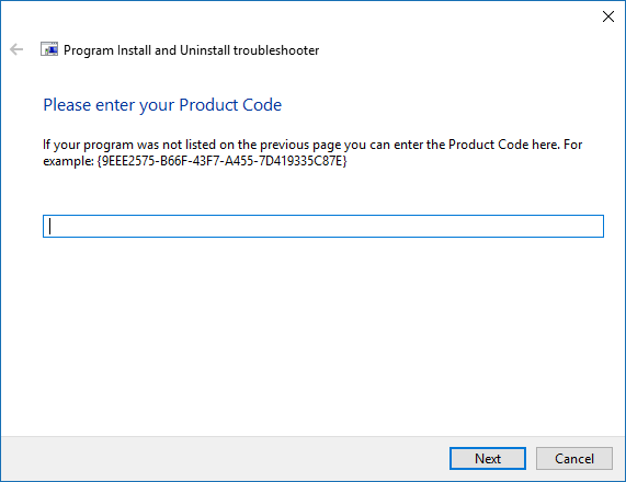

The Microsoft Install and Uninstall Troubleshooter tool has another option if the offending program doesn’t appear on the list … to remove it by Product Code.
Can anyone advise what the Product Codes are for Dynamo 1.3.3 and for dynamo 2.0.1?
Uninstall%20by%20Product%20Code
