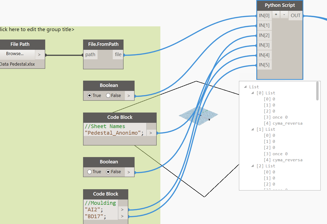

Hello everybody,
i just reinstailled Dynamo and downloaded the latest version on BumbleBee 2016.9.4
Actually before reinstall it was everything ok. Now these are results that i get.
and with BooleanFalse

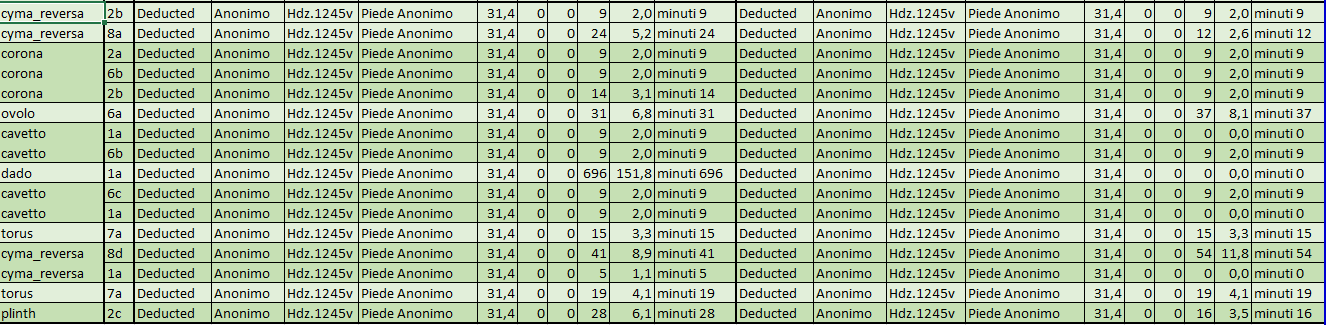

Maybe i need to change something in the script? There no any Error message, just i don’t see the same results that i have on my Excell file.

Is this the same issue that you had last time?
yes, it seems the same, with boolean false, anyway i downloaded the previous version of 19 jun 2016 and now it works properly.
But with boolean true it seems like the node read all 0 intead of the correct value of the cells.
For me with the older version now it works.
Many thanks
Elisabetta

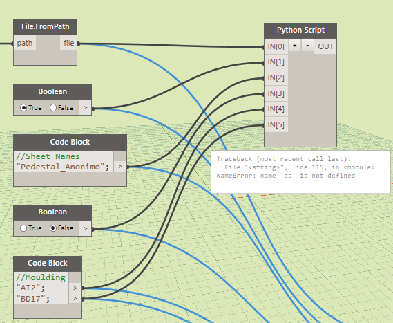

Should be good in the latest version:
thank you very much @Konrad_K_Sobon, you’re so fast on changing codes!!! but actually it is still not working.
it gives to me this message.
Thank you very much
Elisabetta
I should test them before I publish…
Try this
yess. its perfect! Thanks
