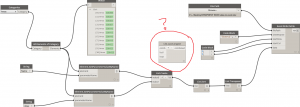

sorry… again,
braiking my teeth here tryin to write to excel…
i’v managed to split my list,and no i want to write to excel: area name as header and areas as colum below
pleas help…
thanks

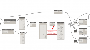

Hi - Think you need to change the lacing to Longest in the List.Transpose Node
Tested with 3 Rooms - was able to get the result desired by you
While with the Shortest Lacing, I got the result like this.
Hope it helps

I think Chandrasekar Rajamani was meaning this:
