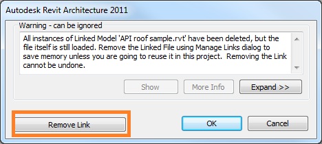

Are there methods to answer dialog boxes or bypass them when running batch scripts?
I am trying to process batches of REVIT project files for various operations. Are there any methods that people have used to bypass or even suppress the message boxes that tend to pop up and interrupt the script from completing? i.e. coordination alerts on copy monitor messages or space is not a properly enclosed region…etc
