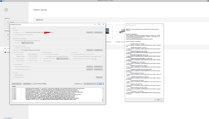

So I will use BatchRVT, I don’t know if you know why but when I try to run the program I have an error message that appears…
