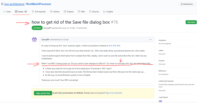

Hi @sovitek , BVN it’s very powerful but I have some issues…
and for “how to get rid of the Save file dialog box”
I can’t find any workaround to make a task schedule. Thanks anyway for the information. Have a good day. Cheers

Hi @sovitek yes of course you are right but in my case I’m fall into “Known Limitations / Issues”
and specially into this issue:
have you any workaround about “When I use RBP, it always pops up “Do you want to save changes to XXX.rvt?” So I have to manually click “No” for all the Revit files…” ?
Thank you very much for your time and your help. Cheers
