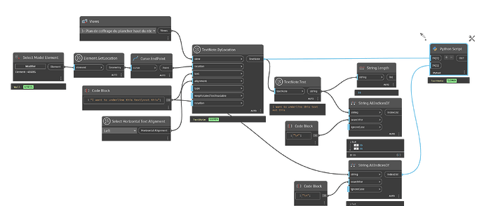

I made a recent post about this but thought I would better explain my problem in a new one. I am trying to get the top line of text to show up underlined for a text note. Now I know there isnt a built in node for this and a python script is need for it. I have no experience with python so it would be really appreciated if someone could show me a python script that I could just add in as a node.
I have attached screen shots so far and add a picture of what the final product should look like. I can get everything except one of the lines to be underlined. Any help on this is greatly appreciated.

Hello @Clayton.Woollen_UVKH one way could probably be split the multiline textnote to single text and use a texttype with underline and the lowest without…ps…please dont create duplicate post, better just give more information in the original post, then its easyer to get help and help…

Here is a deliberately ‘truncated’ solution (an element provided instead of a list but not insurmountable)
The spirit of the forum is to help but at a minimum you must show that you are making an effort and not waiting at all.
Thanks to Mr. Pierson Gartland and Crapai and Mr. Jacob’s referral link for the link on the API
import sys
clr.AddReference('RevitAPI')
import RevitServices
element = UnwrapElement(IN[0])
indexend=IN[1]
underline=element.GetFormattedText()
underline.SetUnderlineStatus(TextRange(0,indexend[0]), True)
element.SetFormattedText(underline)
OUT = element

I was able to get it to work for a list of elements as well.
