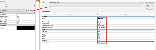

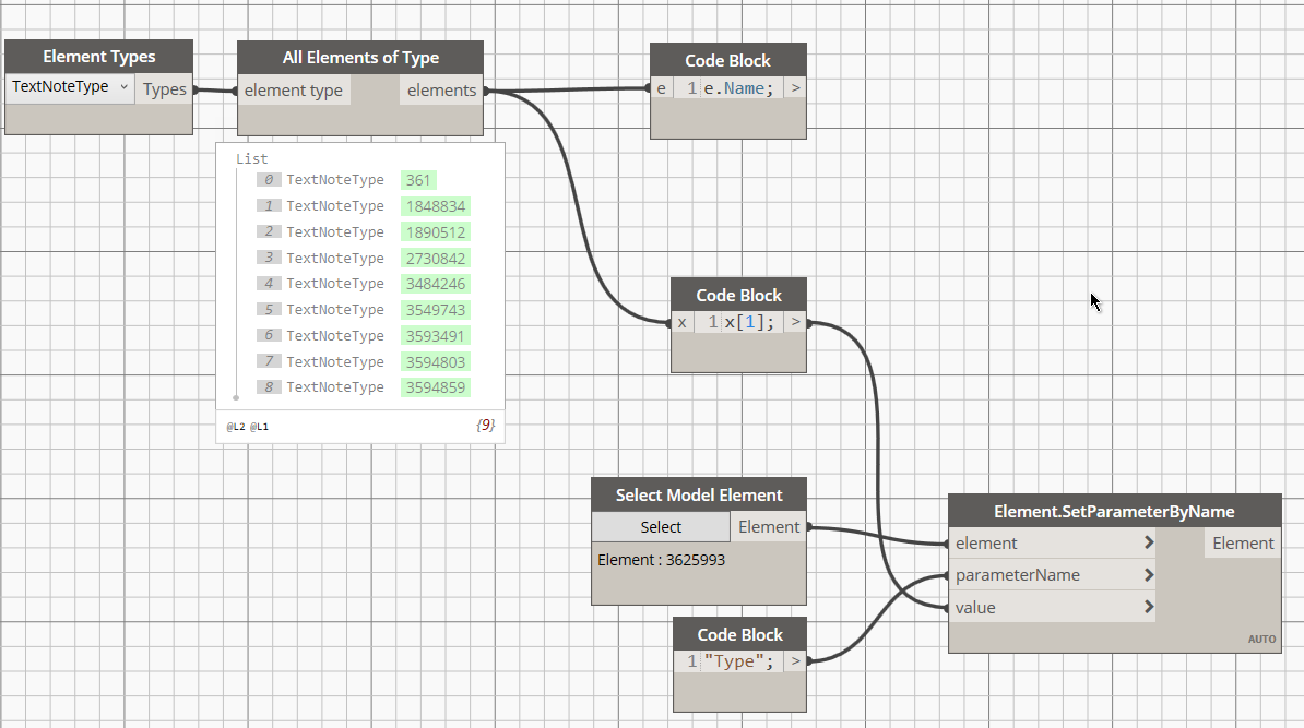

Easiest solution I see is to pre create the text type that you need, and just set it with a SetParameterByName node in dynamo.
Hope it helps.

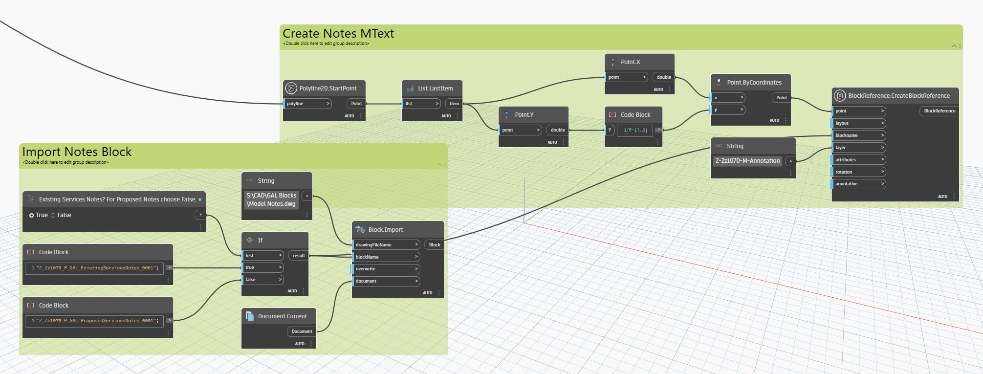

Apologies for not being specific enough. This is for C3D and not Revit. I have found a workaround! Rather than creating the MText through code block/strings node, I have saved the notes as a block in my resources folder. Then, I imported it do my drawing and created a block reference. See the screenshot below:
