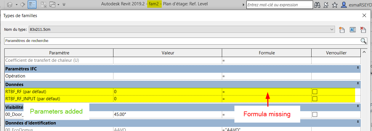

I did a first test using two door families (fam1, fam2). The script creates two parameters, and should place a formula for one of them. For now it executes properly (no error message) but only creates and saves the parameters. It set the formula into the first family but not into the second one. I guess there is something wrong my logic. :face_with_raised_eyebrow:
Result fam1: ok
Result fam2: nok
If anyone has an idea on what’s going wrong, I’ll be infinitly gratefull :slight_smile:

I’ve not taken a proper look at your script yet, but from the sound of it I think you have a laving issue. The node that sets the formula is probably only taking the first item into account and leaving the rest. Try setting that node’s lacing to longest (meaning it will apply the function of the node to every item in the list of the input node).

I tried to set the formula.setnode on longest and received 2 errors. Then I tried to set the document.close on longest as well and it worked perfectly!
