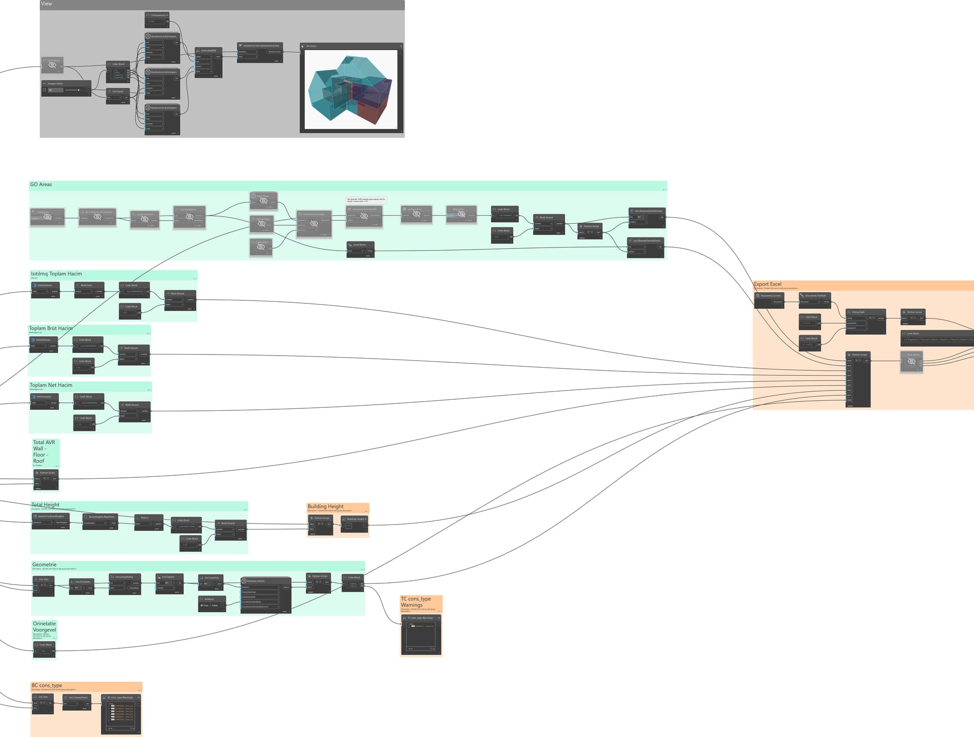

Hi.I have a 3D View output that does not appear in Dynamo player. I am using Revit 2024. It was visible before I formatted my computer, but now it is not. It shows up when I test it on another computer. What is missing on my computer? Can you help me please?

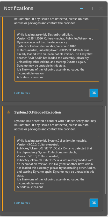

I got some errors. Could that be it?
Yes, the error may be it. Can you share your graph with us to help us debug it? Which version of Revit 2024 are you running, and which version of Dynamo Core? The Dynamo About box will tell you.

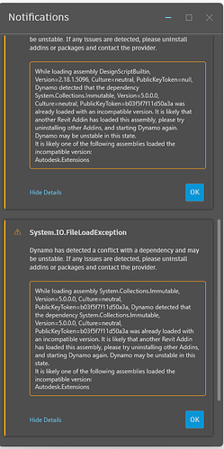

notification:System.IO.FileLoadException:
 Dynamo has detected a conflict with a dependency and may be unstable. If any issues are detected, please uninstall addins or packages and contact the provider.:
 While loading assembly DynamoUtilities, Version=2.18.1.5096, Culture=neutral, PublicKeyToken=null, Dynamo detected that the dependency System.Collections.Immutable, Version=5.0.0.0, Culture=neutral, PublicKeyToken=b03f5f7f11d50a3a was already loaded with an incompatible version. It is likely that another Revit Addin has loaded this assembly, please try uninstalling other Addins, and starting Dynamo again. Dynamo may be unstable in this state.
It is likely one of the following assemblies loaded the incompatible version:
Autodesk.Extensions
 While loading assembly DesignScriptBuiltin, Version=2.18.1.5096, Culture=neutral, PublicKeyToken=null, Dynamo detected that the dependency System.Collections.Immutable, Version=5.0.0.0, Culture=neutral, PublicKeyToken=b03f5f7f11d50a3a was already loaded with an incompatible version. It is likely that another Revit Addin has loaded this assembly, please try uninstalling other Addins, and starting Dynamo again. Dynamo may be unstable in this state.
Autodesk.Extensions
 While loading assembly System.Collections.Immutable, Version=5.0.0.0, Culture=neutral, PublicKeyToken=b03f5f7f11d50a3a, Dynamo detected that the dependency System.Collections.Immutable, Version=5.0.0.0, Culture=neutral, PublicKeyToken=b03f5f7f11d50a3a was already loaded with an incompatible version. It is likely that another Revit Addin has loaded this assembly, please try uninstalling other Addins, and starting Dynamo again. Dynamo may be unstable in this state.
Autodesk.Extensions

I can not download this graph. Can you please send it to me as an attachment?
Thanks,
Neal
I send workspace image as large png format and .dyn file with mail.
solved with clean uninstall and reinstall.
