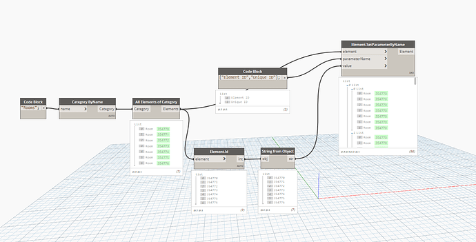

I am trying to write to Revit with the Element ID and Unique ID.
Can someone tell me what i am doing wrong ?
"It says that there no parameter name by “Element ID” and “Unique ID”
Make sure you have the parameter in the Revit.
Hi _Vijay,
So i have to make my own “Element ID” and “Unque ID” in the room element ?
You need to create the project parameters for room.
I am not sure… If i am making a parameter for the Element ID and Unique ID it should have the values that Revit have given the elements… Then I should have the opportunity to “call” it in the parameters… How could i do that ?

What you need exactly?
From what i understand:
When a new element is created in Revit, Revit will give it a unique id.
You can read the id, but you can’t write it.
You can create a new parameter and write the value of the unique id, but that’s just a copy.
There might be a little more to it, maybe someone else has more.
