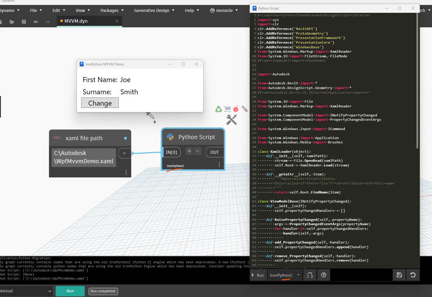

In case anyone is looking to use the WPF with MVVM method in Python, here is a complete solution. note this method only works for Ironpython2
MVVM.dyn (7.2 KB)

IRONPYTHON2 Code:
import sys
clr.AddReference('RevitAPI')
clr.AddReference('PresentationFramework')
clr.AddReference('PresentationCore')
clr.AddReference('WindowsBase')
from System.Windows.Markup import XamlReader
from System.IO import FileStream, FileMode
#from viewmodel import ViewModel
import Autodesk
from Autodesk.Revit import *
#from Autodesk.Revit.UI.IExternalApplication import *
from System.ComponentModel import INotifyPropertyChanged
from System.ComponentModel import PropertyChangedEventArgs
from System.Windows.Input import ICommand
from System.Windows import Application
from System.Windows.Media import Brushes
class XamlLoader(object):
    def __init__(self, xamlPath):
        stream = File.OpenRead(xamlPath)
        self.Root = XamlReader.Load(stream)
    def __getattr__(self, item):
        """Maps values to attributes.
        Only called if there *isn't* an attribute with this name
        return self.Root.FindName(item)
class ViewModelBase(INotifyPropertyChanged):
    def __init__(self):
        self.propertyChangedHandlers = []
    def RaisePropertyChanged(self, propertyName):
        args = PropertyChangedEventArgs(propertyName)
        for handler in self.propertyChangedHandlers:
            handler(self, args)
    def add_PropertyChanged(self, handler):
        self.propertyChangedHandlers.append(handler)
    def remove_PropertyChanged(self, handler):
        self.propertyChangedHandlers.remove(handler)
class Command(ICommand):
    def __init__(self, execute):
        self.execute = execute
    def Execute(self, parameter):
        self.execute()
    def add_CanExecuteChanged(self, handler):
        pass
    def remove_CanExecuteChanged(self, handler):
        pass
    def CanExecute(self, parameter):
        return True
class ViewModel(ViewModelBase):
    def __init__(self):
        ViewModelBase.__init__(self)
        self.FirstName = "Joe"
        self.Surname = "Smith"
        self.ChangeCommand = Command(self.change)
    def change(self):
        self.FirstName = "Dave"
        self.Surname = "Brown"
        self.RaisePropertyChanged("FirstName")
        self.RaisePropertyChanged("Surname")
#    def close(self):
xamlFilePath = IN
print(xamlFilePath)
# Place your code below this line
# Load the XAML file
xaml_path = xamlFilePath[0]
#xamlFilePath
with FileStream(xaml_path, FileMode.Open) as fs:
    window = XamlReader.Load(fs)
# Set the DataContext to the ViewModel
view_model = ViewModel()
window.DataContext = view_model
# Show the window
window.Show()
OUT= 0
