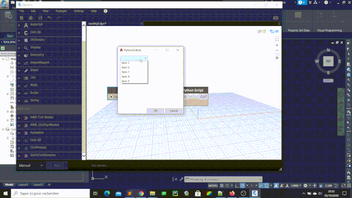

Hello @AdammReilly
here an example of use, the Wpf and Winform methods are not quite the same
import wpf
clr.AddReference("System.Xml")
clr.AddReference("PresentationFramework")
clr.AddReference("PresentationCore")
import System
from System.IO import StringReader
from System.Xml import XmlReader
from System.Windows.Markup import XamlReader, XamlWriter
from System.Windows import Window, Application
class HelloWorld(Window):
	def __init__(self, xaml):
		self._xaml = xaml
		xr = XmlReader.Create(StringReader(self._xaml))
		self.winLoad = wpf.LoadComponent(self, xr)
		self._comboBox = self.winLoad.FindName('pulldown')
		for x in range(1,10):
			self._comboBox.Items.Add("Item "+str(x))
	def okButtonPressed(self, sender, e):
		System.Windows.MessageBox.Show("HelloWorld")
	def CnlButtonPressed(self, sender, e):
		System.Windows.MessageBox.Show("are you leaving us already?")
		self.Close()
	def pulldown_SelectionChanged(self, sender, e):
		System.Windows.MessageBox.Show("you have selected {}".format(sender.SelectedItem.ToString()))

hello = HelloWorld(xaml)
hello.ShowDialog()
