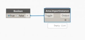

Hi Paul, could you share a picture of the input nodes inside the custom node?
Hi Dimitar
See below. Its nothing difficult and it should work. Any help much appreciated.
I thought you were using some default inputs that were interfering. Everything looks normal, not sure what else could be interfering. Have you by any chance enabled any lacing for the custom node inside the main graph?
No. I’ve done nothing different. Works expanded but not in the custom node. I can’t work it out.
I’m out of ideas. Do you mind sharing the node?

Hi Paul, I had a quick glance yesterday and I suspect that the culprit is the “Convert Between Units” node. It seems like it’s not working properly inside the custom node environment. Could you test your node without it? Also the import instance was a bit inconsistent(i got the types but no instances) prior to me adding the instances as an output.

Thanks for your help! The Convert Between Units was working OK for me. I did as you suggested and make an output for the instances. It is working now and I have updated it on the package manager.
I think the problem is that the rename object procedure doesn’t actually produce a result. If you try to select the CADLinkType nothing appears. As a workaround I’ve just extracted the renaming procedure so that it is outside of the custom node. There might be a way around this but I don’t know what it is.
